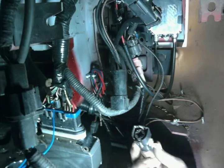

Well we got my car cranking the other day but it took having to jump the starting circuit... There is also a buzzing/clicking from the ccrm... It also keeps dumping fuel so we pulled the fuel pump fuse and the clicking was gone... I installed grounds but the CCRM isnt mounted to anything... its just hanging right now... Im just hoping i didnt mess up repinning a connector when i was extending wires or something.
Well we know the car mechanically will crank so i guess diag has to start here... Have main power at the starter we are not getting power to the trigger wire...
NO POWER AT THE STAR....
Odd thing is we added power to wire 33 going in to the relay... and no changing relay didn't click either.... Weird...
We swapped relays and that wasnt the problem... im going to try to get this running on spring break next week... just wanted to make sure its not something obvious.
Any info or ideas for diag would be awesome. thanks in advance

Ok we have power and trigger power to the relay now. When we add a direct ground to the relay we have cranking so its something on the ground side.
EDIT: Found the bad ground thing is cranking with key to start now.... Next we are on to CCRM fuel pump clicking issue so please check back!
OK here is where we stand. Ground pin 15 is showing weak like with the testlight hooked to power on the battery. Cut the harness and gave direct battery ground to pin 15 (wire 570) g104 and now we have nore more CCRM clicking so its some where on that ground circuit....
Page 10-3 in your EVTM hissin if your following along. So the problem lies in a bad g104, bad connection at c113, c109 or at s105
sorry for spelling issues or miss types on weird wavy shaped keyboard.
CCRM buzz was a miss pin causing a bad ground at C113
