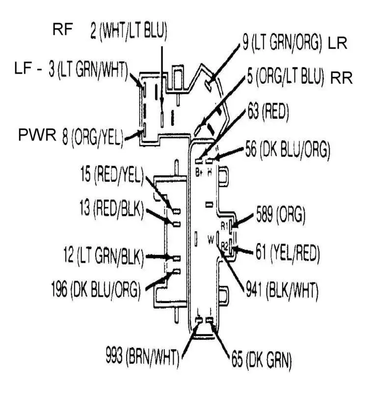

here's the connector view:
cjones
Jul 20, 2002
1,561
37
Avondale, AZ
Jun 18, 2007
#36
  • Jun 18, 2007
  • #36
everyone:
i checked the connector view after a message i received against a 1988 switch and they are the same in the program. the lazy people at mitchel on demand didn't check for differences and just used one chart for all years. (no wonder i always used Alldata)
i don't have an accurate connector view of the true 90-93 switch.
they have different part #'s so there is a difference, mitchell just doesn't show it.
