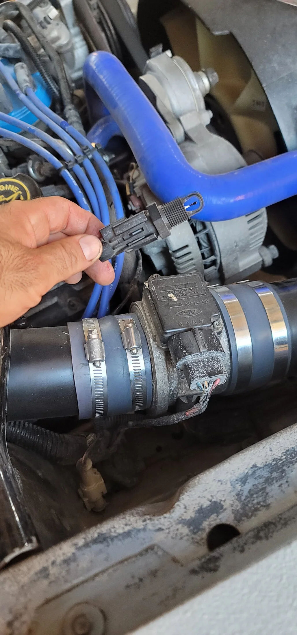

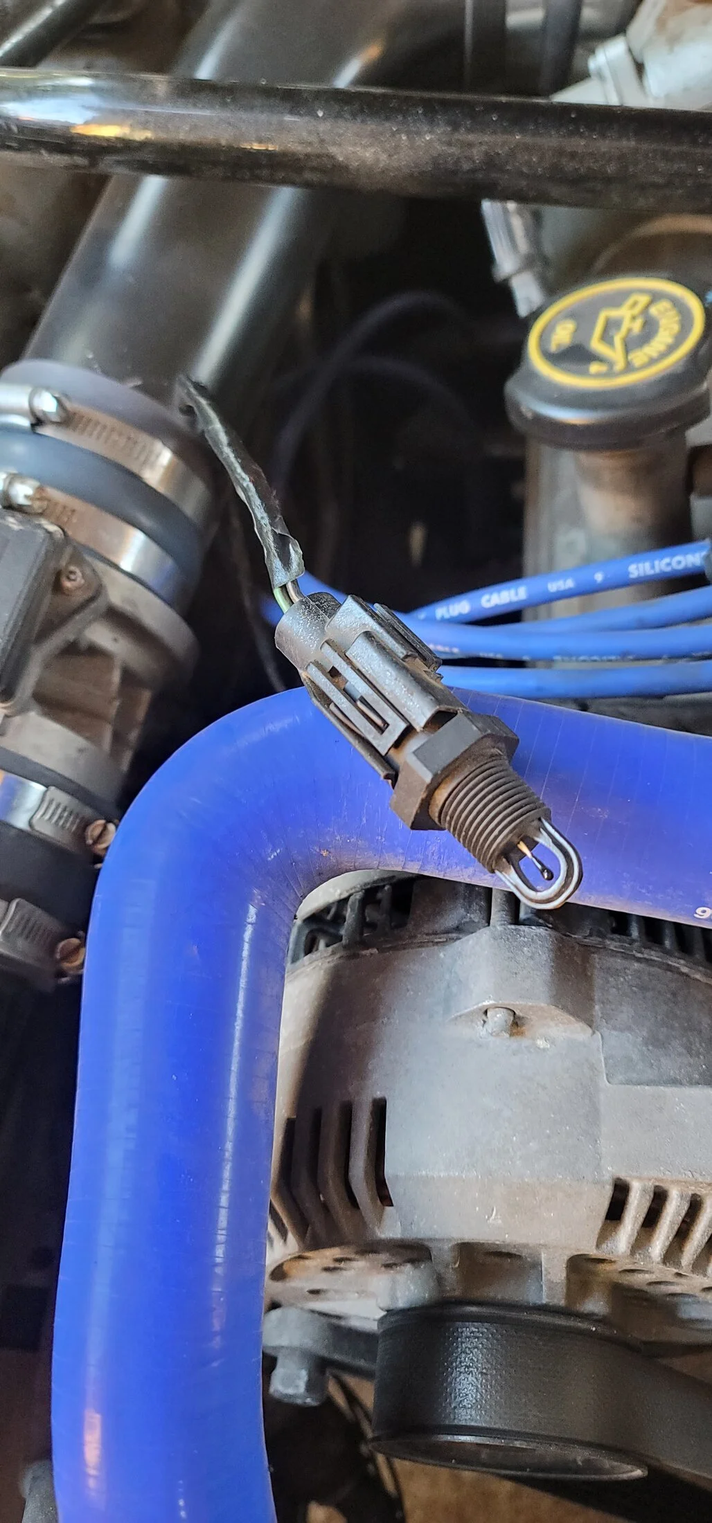

Can someone please tell me where this sensor should go. I recently installed a cold air intake. This sensor was inside the stock air box.

That is the ACT or air charge temperature sensor. Usually mounts in the #5 intake runner on the lower intake. If the car it tuned then you can put it in the air box or in the CAI tubing.

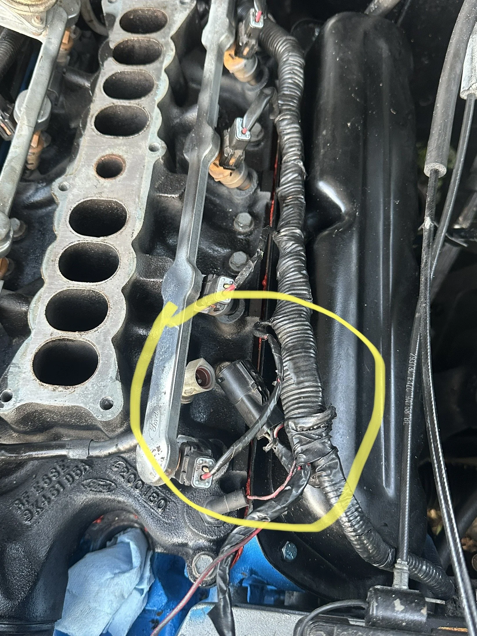

Stock Location:
That will work but realize the ECU is factory programmed for the expected temps in the #5 runner so unless you can tune the car it’s not going to be optimal in the CAI tube.
