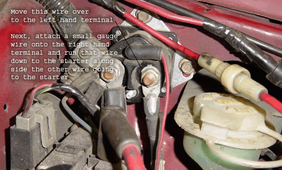

i just need some pics guys. if you can get me a pic of how your wiring is going to your starter selenoid and if possible some info on how your 6AL MSD is wired that would be appreciated.

Starter solenoid wiring

i found this on the inter net! is this what your looking for ?disregard the words on it !

90 foxbody
i rerouted alot of my wiring and for some reason i can't get the combination right that needs to hook up to the selenoid. the pic helps a little but for some reason when i hook my battery up my headlights come on and when i turn the key to crank it i get nothing but a click from my fuel relay and thats it. right on jrichker that should figure out something for me.
