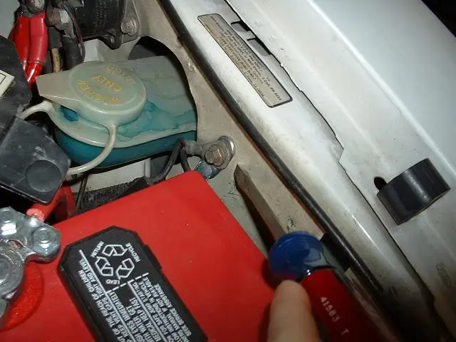

The main power ground is from engine block to battery: it is
the power ground for the starter & alternator.
The chassis ground and battery pigtail ground go to the bolt being pointed at in the following photo.
Picture courtesy timewarped1972
