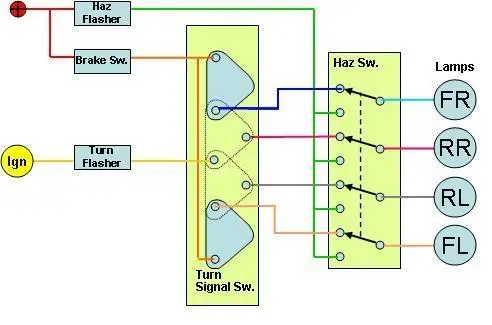

Hey guys, I don't have an emergency flasher knob in my car, I have the wiring harness sitting in there though. I can't find a decent priced flasher switch around anywhere, so I bought a regular rocker switch. Here's my wiring idea: the power from the flasher goes to one side, and the on side will have teh wires going to the lights. What do you guys think? Will it work?
What i did was simply put the three wires (wires going to the left front indicators, the right front indicators and the brake) all into one terminal, and the hazard flasher in the other terminal. When i flicked the switch it worked! only problem... when i would use the turn signals... all of them would light up and flicker as well
well... after an hour of troubleshooting i figured out that yes indeed, the switch was the problem. I'm not sure how to fix it, I'm still pondering. Any suggestions? are there such things as one way circuits or something? like some type of wire that only allows current to flow one way? if so i got it made!
