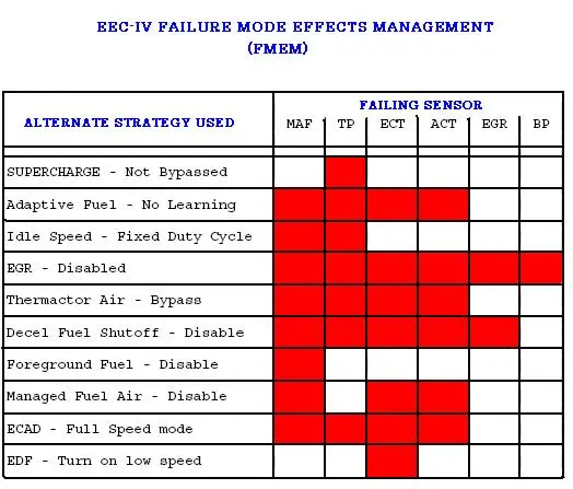

Technically that's not how it works. Even with the resistors, you will still get and EGR code. Code 33 will be logged because the computer is still not sensing EGR valve movement. So the computer still knows the EGR is not working, its just a code that doesn't turn the CEL on. So no timing will be added and no fuel trims will be adjusted.
I've mentioned it before, but any time that any of the EGR related codes are logged, the computer bypasses the EGR part of the strategy.
Here is the direct quote from the actual Ford GUFB strategy guide.
The EVP sensor failure Mode strategy will force the EGR valve to close and will have no adverse impact on Spark or Fuel.
Exactly, the resistors prevent you from getting the CEL and internally the ECM disables the spark advance w/EGR. Without the resistors you get the code and it messes with timing. Personally I have a Moates so I took it out of the tune, but prior to that I just used the resistors (in fact they are still installed) with no bad effects. After I removed the EGR but before I put in the resistors I had the CEL and did notice it ping a couple times before I put in the fix shortly after.
