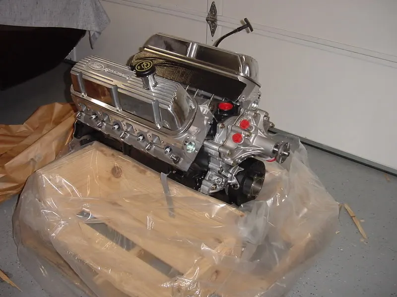

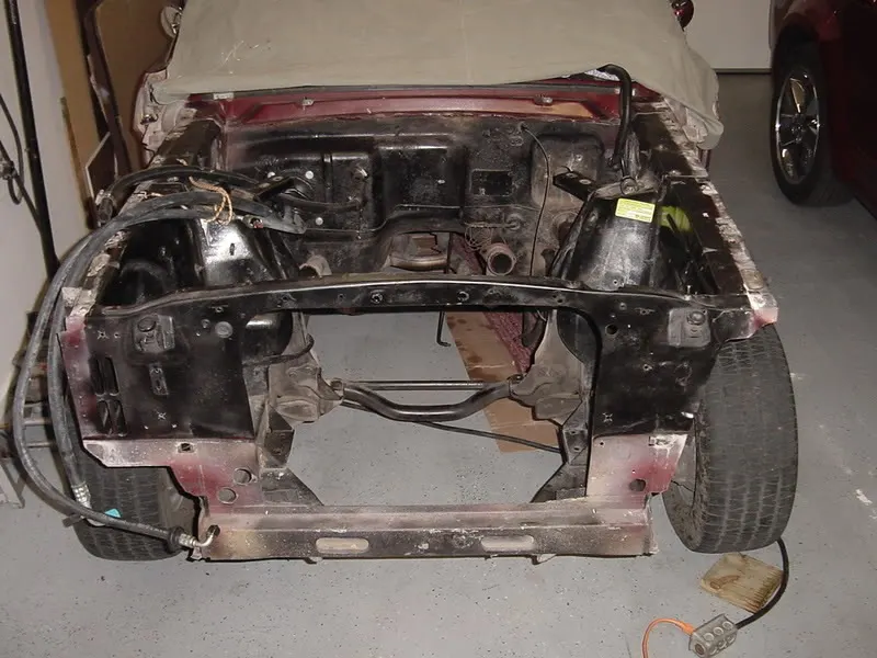

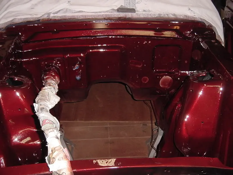

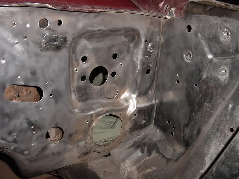

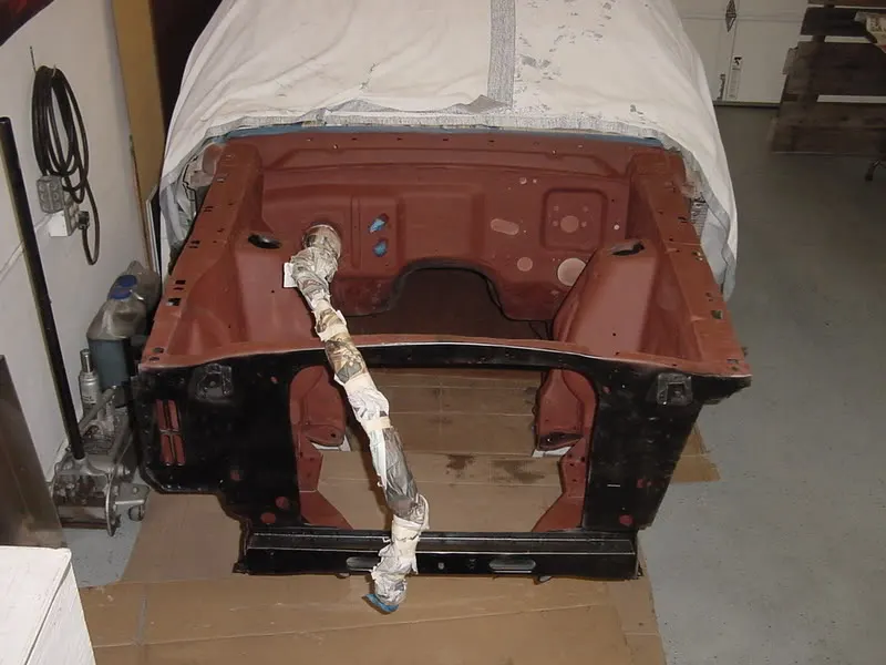

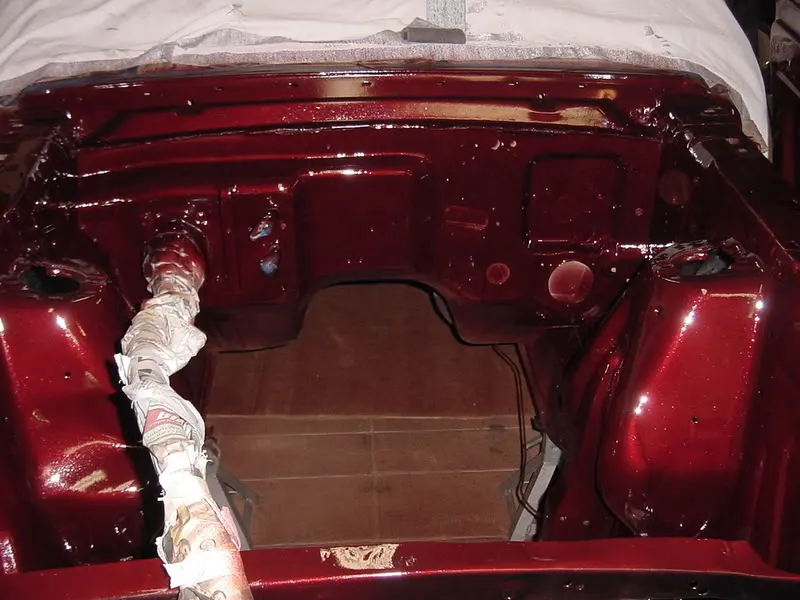

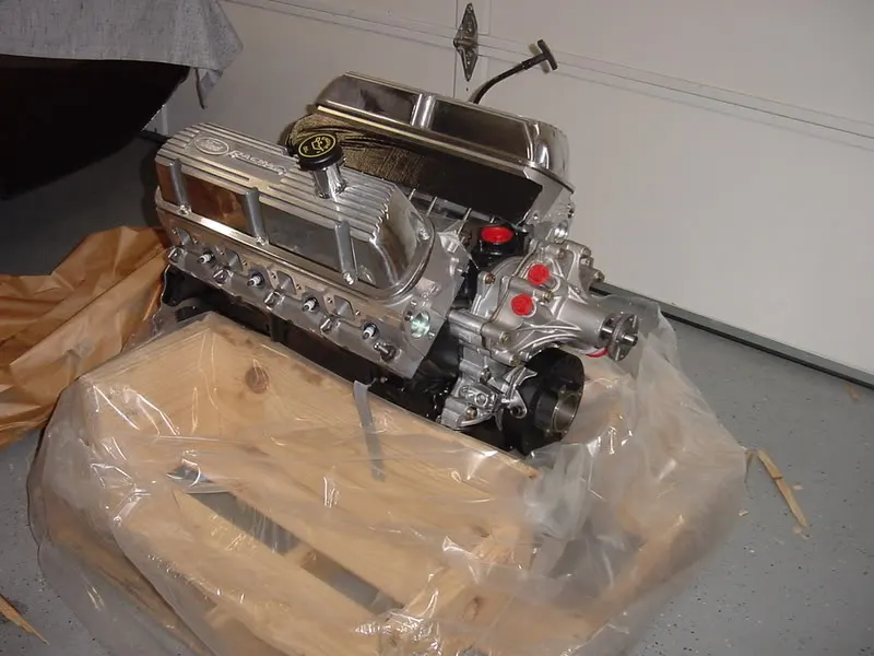

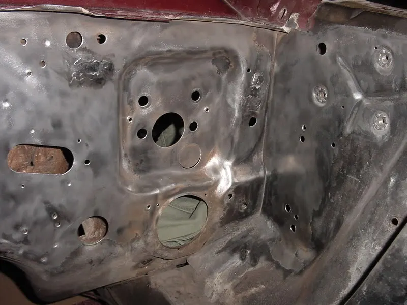

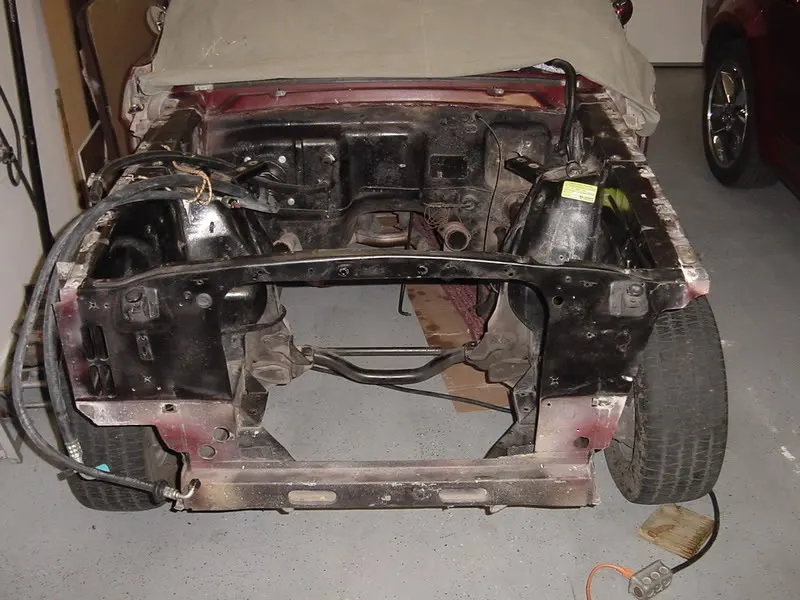

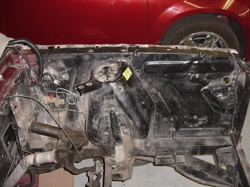

Got my new engine and just couldn't drop it into a nasty engine bay, so...
Ford Racing Crate motor

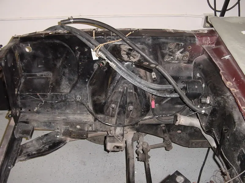

The Ugly

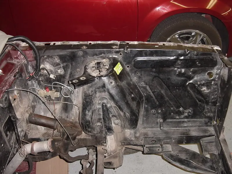

Stripping process

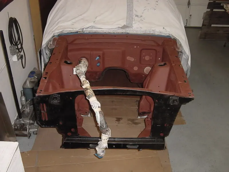

Primed
I went with the body color

coolblue65
looks great, how did you strip off the old paint?
Mostly disk and cup type knotted wire wheels and a flap disk on a 4 1/2" angle grinder. Some areas with my air powered 2" right angle grinder with 60-120 grit discs. And some tight areas with small wire wheels with my elec drill.
Messy work, I was wearing a hat, safety glasses, ear muff tpye hearing protection and a dust mask. I still got crap in my eyes and nose and hair.
i've graduated to a full respirator instead of the old dust masks, especially when painting. i was getting horrible sinus infections, prone to them anyway, and i couldn't take it anymore. found a pretty nice respirator at home depot for less than 30 bucks and it works great.
