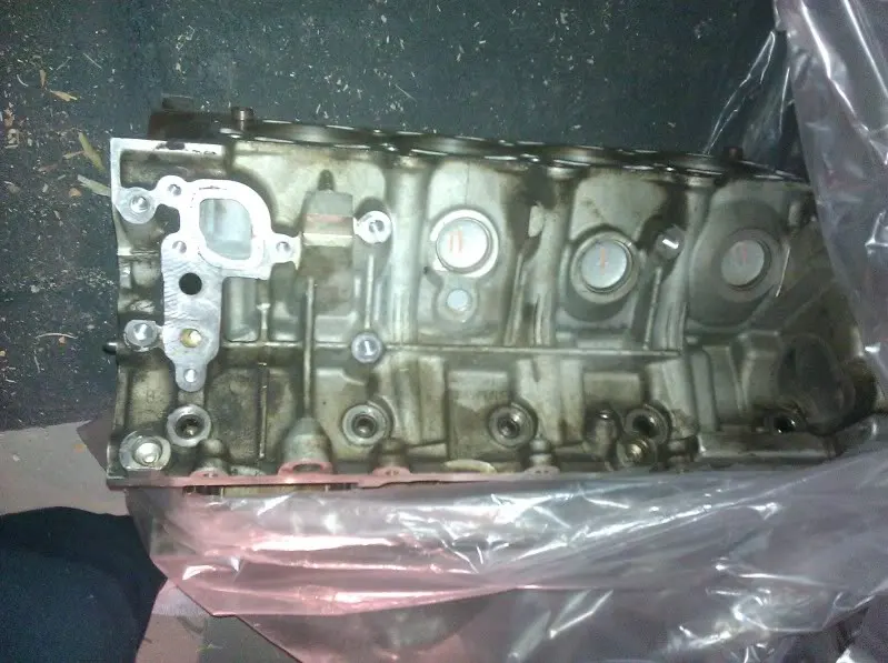

Are you talking about the block part number? It should be on the side. This is a picture from a 4.6l teksid block I have sitting in my garage. The part number in on the drivers side under that first freeze plug (center in the picture.)
No, not the casting number but thanks for the info. The one I'm looking for is the vehicle identification number. I'm about to buy a 2000 GT and the seller said the car has a 2004 GT motor in it. He doesn't has the receipt for the motor and therefore I don't know if it's true or not. The only way to find out is to look for the VIN that stamped on the block. I know the old 5.0 motor has the last 8 digits of the VIN stamped on flat surface on the back of the motor right below the lower intake area. Not sure about the 4.6L block.
They no longer stamp any part of the VIN on/in motors.
