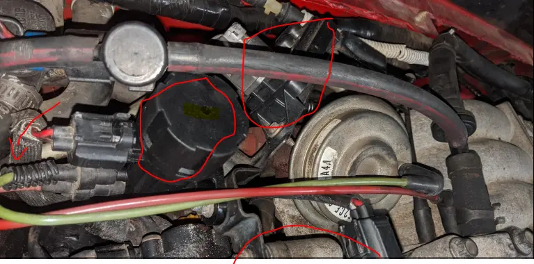

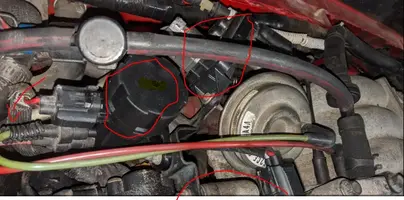

I replaced these 4 sensors. The bottom area circled is the IAC. The arrow to the left is the purge canister.

Two of the parts circled are for the EGR system. The upper right part is the DPFE sensor. The part near the middle is the EGR vacuum solenoid.
As stated very early on in this thread that excessive EGR flow can cause loss of power. The key to this whole problem is to figure out WHAT changes when the problem occurs.
In the same way as trouble shooting an EVAP problem the way to trouble shoot a suspected EGR problem is to monitor the DPFE sensor. Looking for an increase in EGR flow when the problem occurs.
The low tech approach is to disconnect and plug the EGR vacuum line. Does this improve the issue? The limitation of this method is it won't work IF the EGR valve is stuck open. For this a manual block off gasket between the EGR valve and the TB is what the doctor ordered.

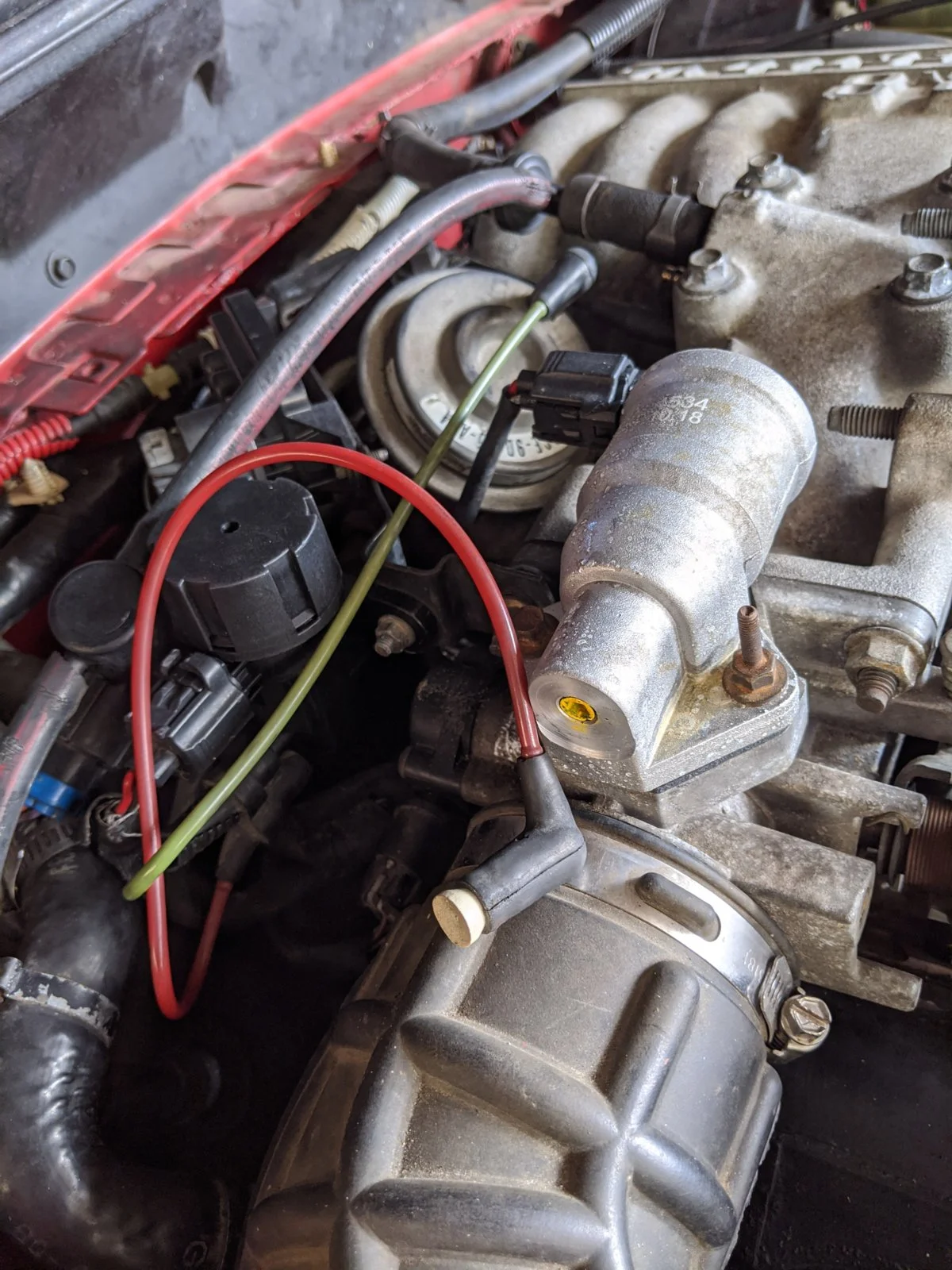

I blocked off the hose (as photo shows), it didn't improve the issue.
I then made a metal shim and installed between the EGR and TB, this also didn't improve the issue.
Also through all this I never got a engine code.

The vacuum hoses in question control the EGR system. When disabling the EGR system and not getting any improvement, this tends to say that EGR is not your issue.
How about the EVAP system? Have you disconnected and plugged the EVAP line?
