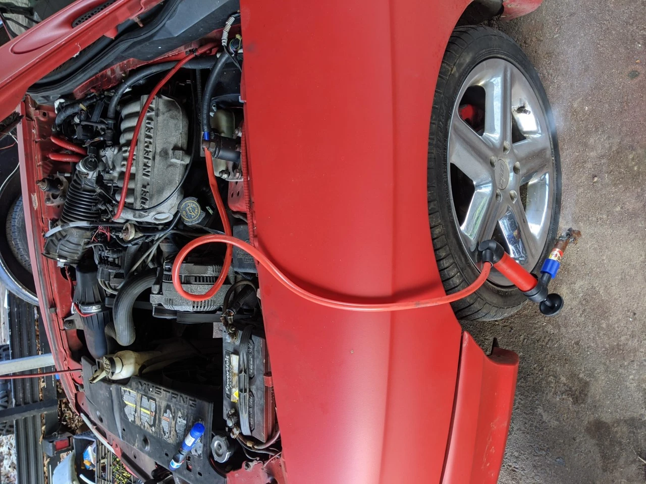

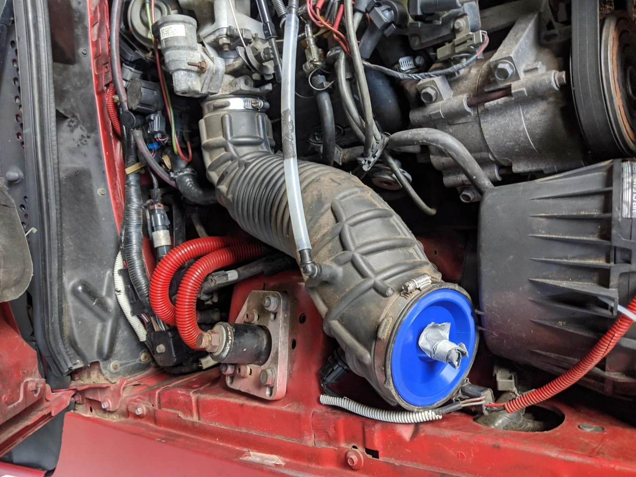

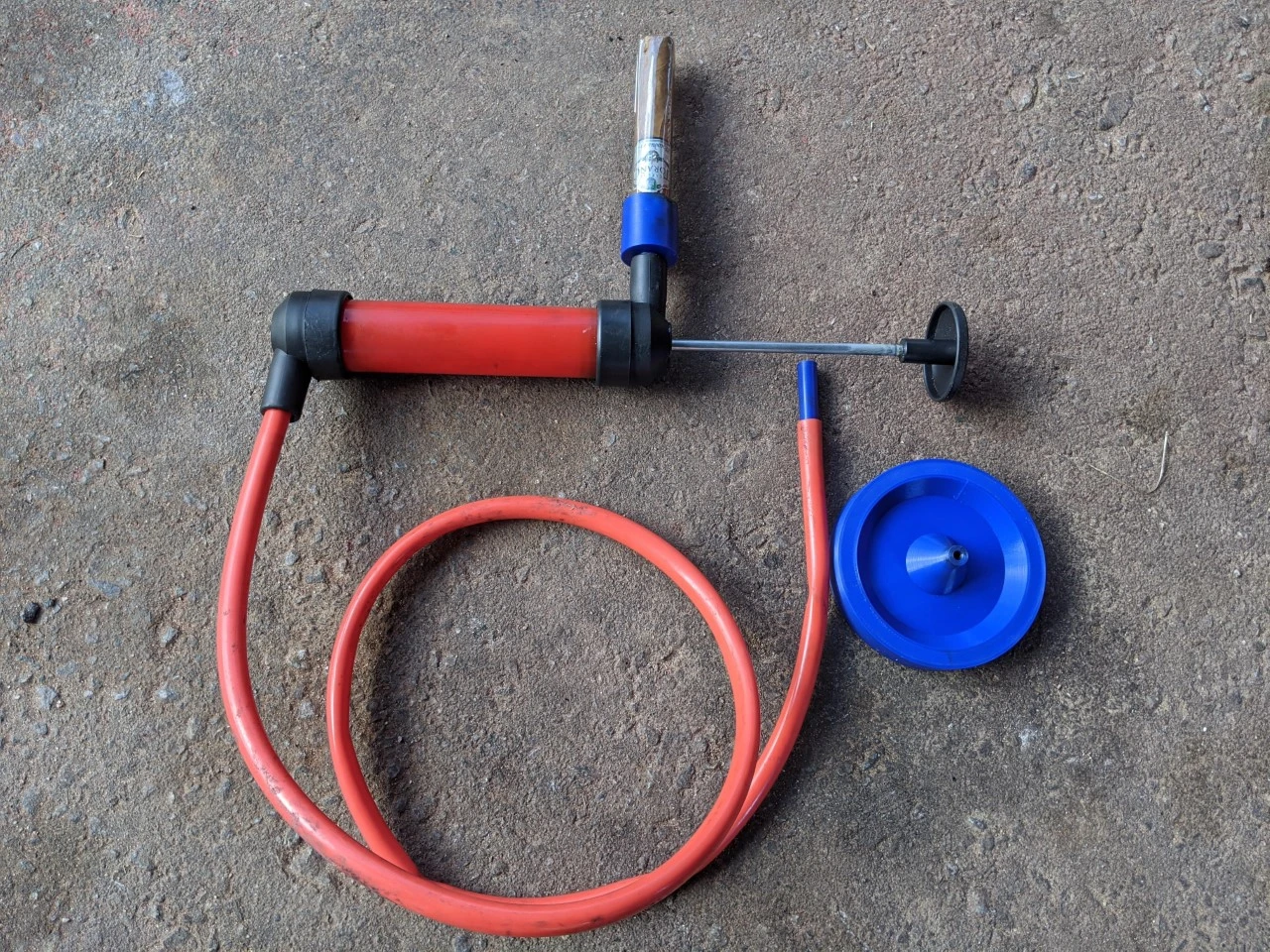

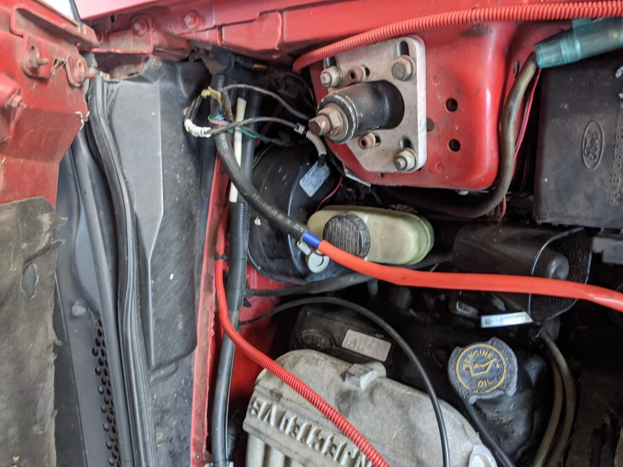

I have a cheap 3D printer and printed out some adapters to do a smoke test. (pictures enclosed in case someone else stumbles on this thread and needs a cheap smoke tester idea)
This video shows when I had the system pressurized from the brake booster side. No smoke is seen. At the end of the video it shows me taking the ducktape off and the smoke coming out. I also attached the hole to this adapter and pushed the smoke the other way...no smoke escaped.
View: https://youtu.be/mbHytUVv0YQ

Once again I took the mustang for a spin after installing the fuel injectors. It ran fine for a few minutes, although once it bogged during acceleration It would no-longer accelerate. Every time I would pull to the side of the road...turn ignition off...start right back up (not even waiting 2 seconds) then take off and everything is fine to accelerate for a few minutes. Then all the repeats until I'm able to limp it home.

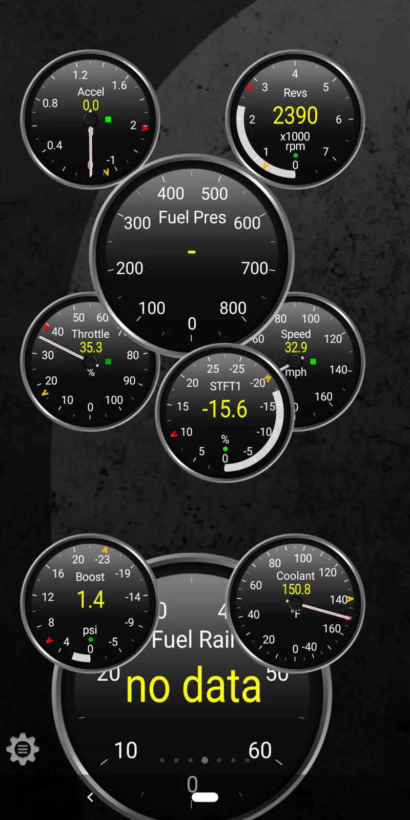

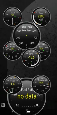

I threw up some random gages on torque today the short term fuel trip seemed to move alot. The - 15.6 is when it was running fine and the 32.8 is when it wasn't

At 150-165 the motor is way too COLD. Or there's air trapped inside the motor (air will make the ECT read low). The stock T-stat is 192 degrees F. The cold motor will affect the open/closed loop operation. This will also affect the PCM"s target air fuel ratio. The PCM needs an accurate engine and outside air temperature.
If you are not using the Ford stock T-stat, go back to the stock T-stat temperature. Follow the V6 coolant refilling procedure EXACTLY. The motor temperature should be at least 190 degrees just idling in your driveway.

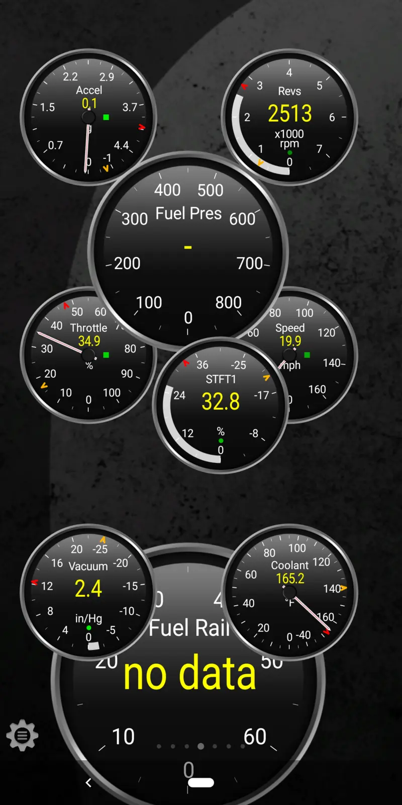

In general. IF the fuel trims shoot up (adding fuel) when the RPM's are about 2500 this means that the motor is starving for fuel. But before you can make that assumption it's important to VERIFY that the O2 sensors are actually providing good data. IE. do they switch in response to change in mixture? One quick test for this is to monitor the O2 sensor voltage (or graph). Create a vacuum leak. Do both O2 sensors shoot lean? Does the O2 sensor go back to switching lean/rich when the vacuum leak is restored?
When you know that the O2 sensors are functioning, start by looking at the long term fuel trims (LTFT). The short term fuel trims change too fast to look at general trends. Use the STFT's when trying to zero in on the problem. Compare the LTFT's at idle. Then raise the RPM's and hold steady. What do the LTFT's do?
The key is to figure out WHY the fuel trims are changing sooooooooooo much. Possible causes:
  • The MAF flow suddenly changes
  • The O2 sensors suddenly switch lean/rich or rich/lean
  • EVAP VMV opening allowing a vacuum leak or a Vacuum leak that comes/goes.
  • The fuel pressure suddenly changes. Given the fact this car has a mechanically fuel pressure regulator, IMO this is less likely.
  • Clogged fuel injectors.

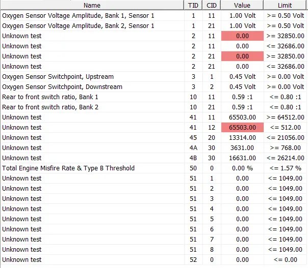

Have you looked at the ODB2 mode6 misfire data? This is a very powerful tool to see if there's a problem tied to specific cylinders.

I haven't looked at the ODB2 Mode6 data, I still have to figure out how to do that.

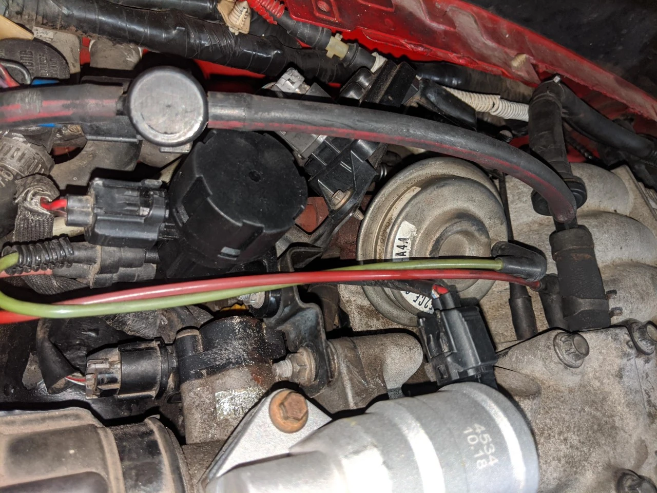

Which hose are you recommending blocking off? The red 1? Even though I'm still getting the same results...I really feel like you are getting me close.
