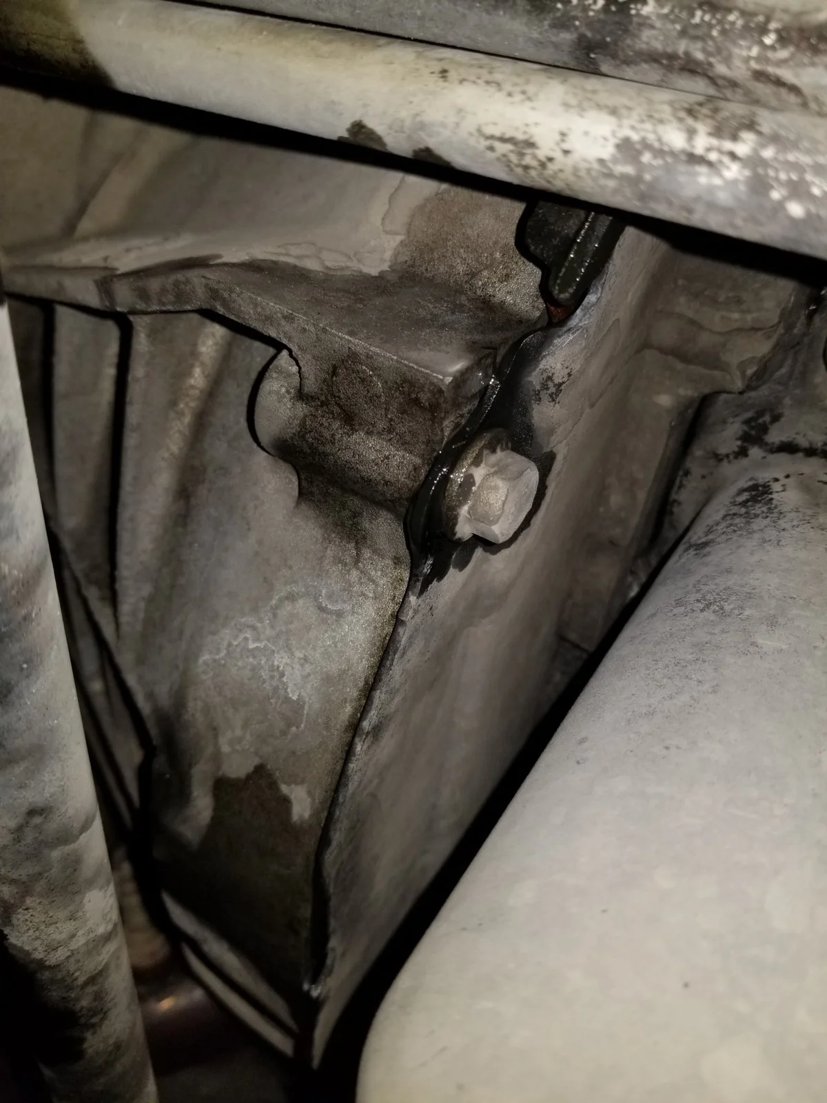

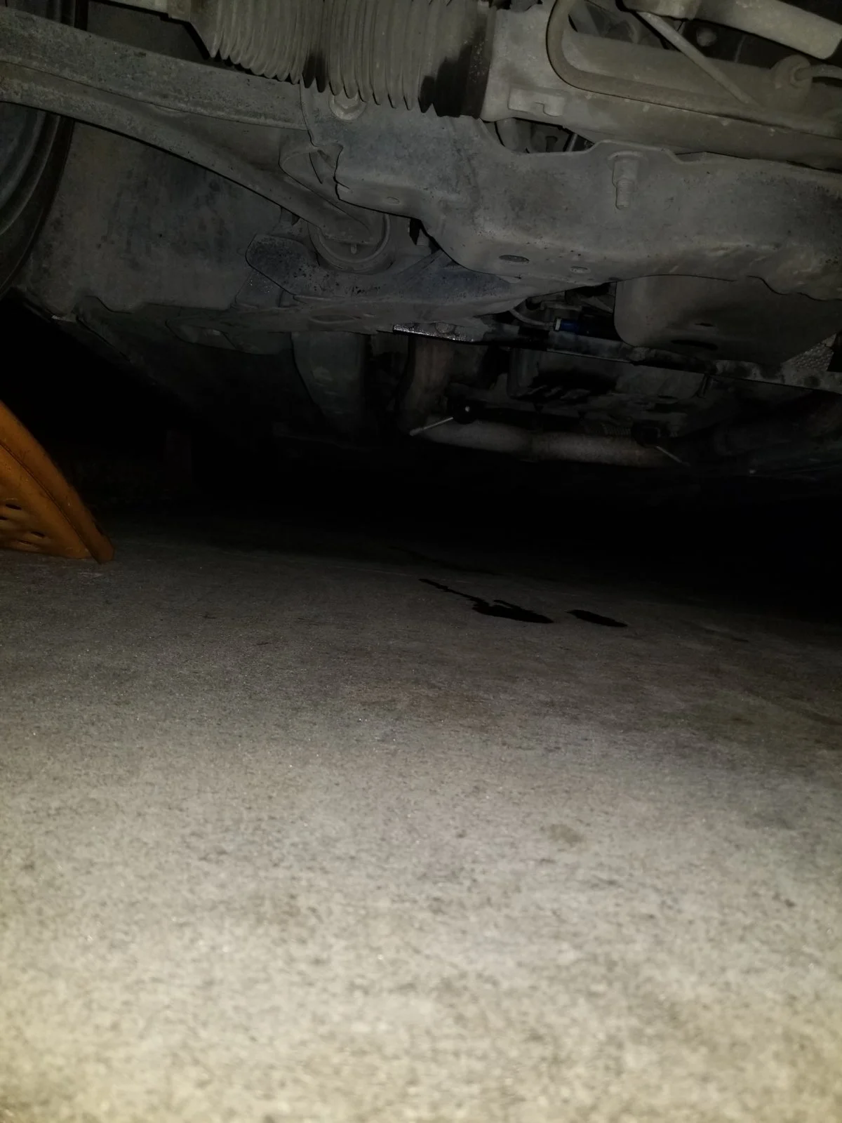

C C-Quick New Member Jan 9, 2018 2 0 1 Jan 5, 2019 #1 Jan 5, 2019 #1 I have a coolant leak which causes the engine to start smoking. I cant figure out where the leak is coming from. I have 2008 mustang gt. Attachments 20190105_181126.webp 148.3 KB · Views: 289 20190105_182416.webp 114.5 KB · Views: 297
RaggedGT Been here over a DECADE and still no CT Mod Dude Jul 20, 2014 4,766 3,224 203 Taylorsville ky Jan 5, 2019 #2 Jan 5, 2019 #2 Top the coolant off with water and put a pressure tester on it,you should be able to see the leak then
G Goliath85 New Member Aug 28, 2018 3 0 1 Indiana Jan 6, 2019 #3 Jan 6, 2019 #3 with it running down the back side of the engine, it's more than likely the intake or the heater hoses. It could be filling the engine valley and running out the back.
G Goliath85 New Member Aug 28, 2018 3 0 1 Indiana Jan 6, 2019 #4 Jan 6, 2019 #4 but I agree with RaggedGT pressure test will definitely be the easiest way to find it.
