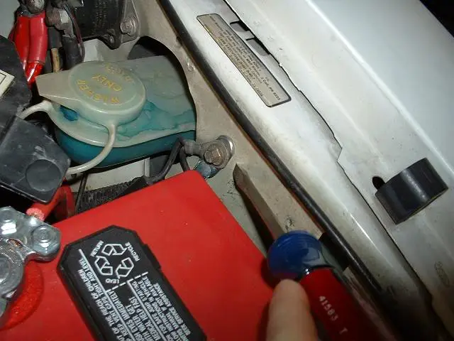

Check your alterantor power ground. Here's part of my standard tech note on grounds...
Grounds are important to any electrical system, and especially to
computers.
1.) The main power ground is from engine block to battery: it is
the power ground for the starter & alternator.
2.) The secondary power ground is between the back of the
intake manifold and the driver's side firewall. It is often missing or
loose. It supplies ground for the alternator, A/C compressor
clutch and other electrical accessories such as the gauges.
Any car that has a 3G alternator needs a 4 gauge ground wire
running from the block to the chassis ground where the battery
pigtail ground connects.
The 3G has a 130 amp capacity, so
you wire the power side with 4 gauge wire. It stands to reason
that the ground side handles just a much current, so it needs to
be 4 gauge too.
Picture courtesy timewarped1972

Where do i hook that ground strap up to on the drivers side firewall.
I have the wire dangling but i dont know where it goes.
1.) The main power ground is from engine block to battery: it is the power ground for the starter & alternator.
2.) The secondary power ground is between the back of the intake manifold and the driver's side firewall. It is often missing or loose. It supplies ground for the alternator, A/C compressor clutch and other electrical accessories such as the gauges. Any car that has a 3G alternator needs a 4 gauge ground wire running from the block to the chassis ground where the battery pigtail ground connects.
Picture courtesy of timewarped1972
Bolt one end of the 4 gauge wire to the engine block where the battery grounds. Bolt the other end to the common ground point on the driver's side chassis where the screwdriver is pointing to in the above photo.
