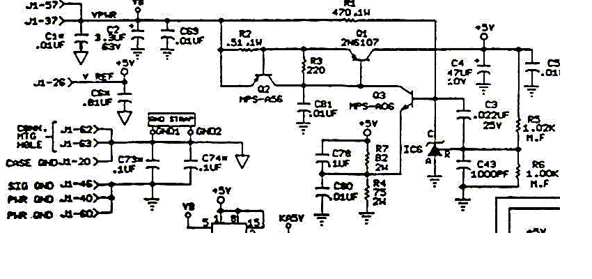

The sudden removal of the load from the output causes a spike in output voltage just before the voltage drops off.
As far as having a filter in the power supply input of the common A9L computer, there isn't much of a filter network except a couple of caps to dampen some of the high frequency electrical noise.
For any kind of power filter, I would expect a 10 MFD soild cap, a toroid coil and a .1 MFD cap on the back side of the toroid. That isn't the case with any of the computers I have opened up for inspection.
See the attachment and you'll see what I meant. It is part of the actual A9L schematic. I will be glad to share the link or the diagram with anyone who is interested.

Although I'm aware that there is a spike, what I'm not aware of are any spikes sufficient enough to cause elsectrical damage. Anyone ever see damage as a result of disconneting the battery on a Fox?
An alternator is regulated, but how it’s regulated is what makes the difference. The alternator’s comprised of basically four components, the armature, the field winding, the diode bridge, and the regulator. The armature generates an AC voltage that’s dependant on rpm. The current, however, is dependent on the magnetic field that it sits in. Since the final output voltage is a product of output current and load, it’s then dependent on that magnetic field. The regulator then adjusts the final output voltage by adjusting the current through the field windings, which determines the magnetic field that the armature sits in, which determines the output current and, in the end, the output voltage. The problem with disconnecting the battery lies in the fact that it takes 2-3 thousandths of a second for the magnetic field generated by the field windings to collapse, so even when the regulator shuts off the current, the armature output current remains what it was for a short time. The battery is a very low resistance source, so as the load changes, the battery keeps the voltage stable.
Keep in mind that although 2-3 thousandths of a second seems to be a short period of time, it’s excruciatingly slow when compared to most electronic circuits, and although it may not damage the EEC immediately, the alternator can easily spike to 120V and exceeding the breakdown voltage can very well lead to a failure at a later time du to damage to one or more of the P/N junctions of the components.
