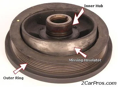

I've seen the harmonic balancer come apart and make a noise similar to that. The balancer has a rubber sleeve inside that wears out or pushes itself out and it causes a god awful noise when it does. Sounded like the engine was coming apart! Sometimes the rubber will stick out or you can see it wobble. Might be worth a look...

I'll take another video of the balancer. My dad actually thinks it's either the balancer or a bearing down low as well.

Winter can be hell on rubber parts, definitely check it out. The rubber wears out and causes the inner and outer rings to "knock" together. This is not a mustang balancer, but you get the idea
