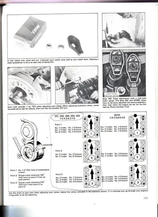

Here is a 1 pager from Crane on installing/adjusting pedestal mount rockers for 77 & up SBF. Take a deep breath and start from the begining to ensure each step is done properly. Sounds like you may not have had the cam lobe in the correct position when you adjusted them. Also pay attention to the instructions regarding possible need for shims. Good luck and report back your results.

Hi
check this...
the way to set correct valve lash, which is for hydraulic lifters zero lash do the following!
See the link i posted...
As you van see on it, the pulley gives three positions. These correspond with the 1,2,3 pictures on the right. Above it you can see for which engine (221, 255, 260, 289 etc)
Each valve must have ZERO lash. Tighten the rocker for each valve which is BLACK so that the rocker cannot move and is tight on top of the valve. Do this by gently tightening the rocker with one hand, and feel with you other hand when it tight.When you have this, turn the screw 1/2 to 3/4 more tight.
This way you have the lifter pushed down. Do this with al the valves according to the drawing.
When your done, you should have correct valve lash and the sound should be gone.
