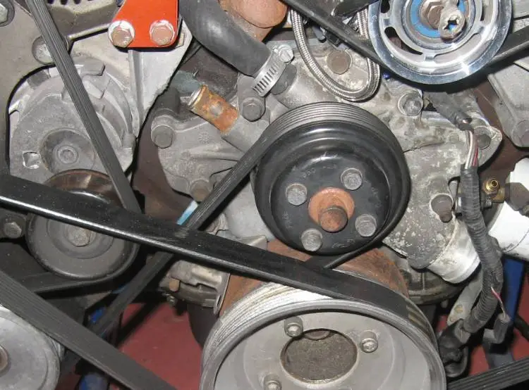

Just wanted to know if there is a place to buy auto nuts and bolts for the engine bay that dont rust (if there is such a thing) or look like crap..
Like this:
The bolts on here...Im tired of bolts on top looking like crap...like the ones on the alt, the ones that hold in the idler pulley and Vortech, etc.
THanks

Now that the pic is up...I will clarify..see the bolts holding the red piece...CRAP.
The ones on the WP are not rusted but are dingy gray...dont know if you can get those in stainless steel so they are strong AND look nice.

If you want to do real bling, get all 12 pt chromoly ARP, if not do Grade 8

fastenall(sp?) should have what you need.
Grade 8 should also stay nice. I replaced my valve cover bolts with 8's and my water pump/timing cover/alt. with SS ones from the hardware store.
When I re-install my lower/upper I am going to replace the stock bolts with 8's or SS. I need to hit up fastenall to see about some new upper bolts as one is kinda worn.

You can buy kits that are chrome. You can go to Fastenall, Tractor Supply, Lowes, or Ace and just buy the same bolts you remove with the zinc coating.

Chris...Im assuming the ones in the above pic are the 12 pt? I dont want to do EVERY bolt, just the 15-20 that are most visible under the hood when you pop it.
Where do you get those ARP ones?

$500??? Why would you think that the mark-up would be $500.00 when you can by an entire chrome kit for like $75 off Ebay or from Summit?? There are not that many "exposed" fasteners on an engine anyway. Sure you will spend some bucks for chrome plated bolts, but 10 bolts from Fastenal for a Harley ran around $30.00. Chrome will rust unless tended to with wax, so moisture will bead off of them. Zinc is OK, but heat tends to deteriorate the plating over time. Stainless is great for not rusting, but will fade out to the grey your describing over time. The best case scenario, is paint. You can remove the bolts, wire brush,clean with brake cleaner, line them up through cardboard with heads facing up and spray them with heat rated paint. I prefer black, and then if you blemish when you reinstall, you can easily use a touch up paint.
