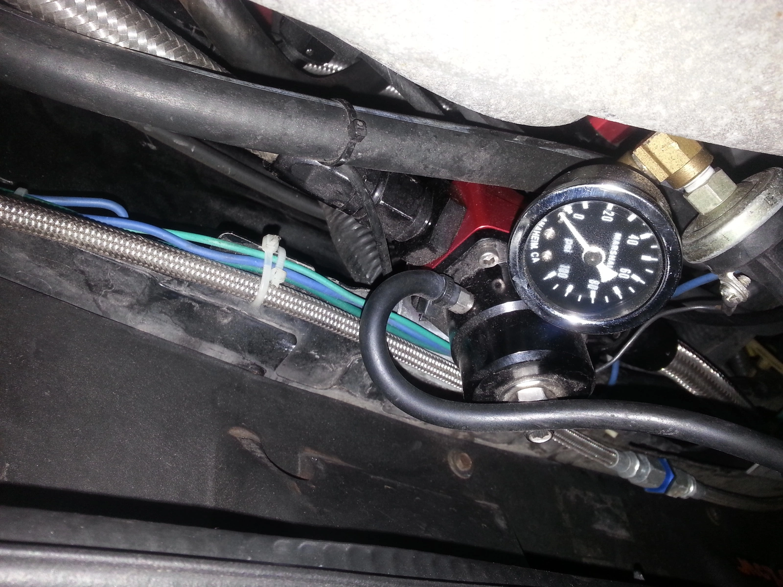

Well no more oil issues after installing external breather. BUT now it idles horribly, chokes and pops when I press the accelerator WOT, and the fuel gauge reads 40psi when no load, but once I had the wife hit the accelerator it dropped down to 15-20psi. This thing is falling apart on me in 2 weeks. I'm thinking maybe the fuel pump? But lately there has been more of a fuel smell in the garage than there used to be. I have the big aeromotive pump and the large injectors/rails, etc so it's set up but no fuel/horrible psi. This thing went from fun to pain in the butt.

With the breather and a working PCV you are now sucking a massive amount of un-metered air into the intake so the ECU fuel calculations are useless. How are the system electronics being managed? Is the ECU chipped and are you using a FMU? I suspect there are a couple of things happening that more info would help narrow down the problem. Have you pulled the trouble codes?
I know its been reprogrammed for all the add on through a dyno tune. How do I go about knowing if it's been 'chipped' and what is an FMU? I'm going to take it to the shop this week for codes. I rented a code reader yesterday but it was for 96+ Mustangs, so it wouldn't read my car.

I'm baffled. I don't want to start throwing money into parts that aren't the culprit. The fuel pump alone is 500 bucks. I can't imagine a dirty MAF causing my fuel pressure to drop while I put it under load?
