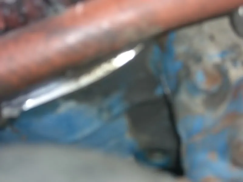

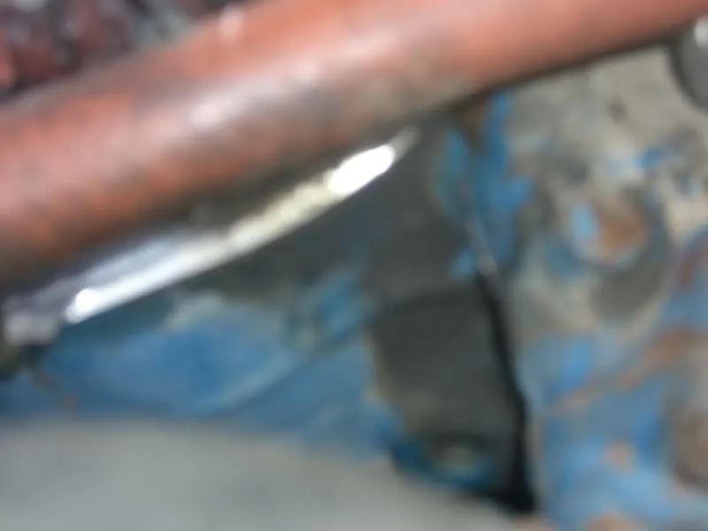

Here was mine when I first got it:
The second pic is taken in sunlight, the first one was taken in the dark, i guess that's why they're different colors.
Here is after I degreased and cleaned up some wiring
What is this black stain?( the chrome part is the valve cover)
My question is, how do I remove the paint off of the current engine block and parts? or should I just paint over it?
The mustang monthly article suggested media blasting, but I dont have a cherry picker to take the engine out =(. Any other suggestions?

its gonna be huge pain in the ass to do it with the engine in there but i guess it can be done by cleaning it all up by hand and the spraying paint but id really just wait and do it the right way.
cherry pickers arent that much...and could be rented. might even wanna try craigslist...hey you could clean up the engine while your at it...maybe add some stuff...
either way....its your back thats gonna be broken trying to scrape and sand while hanging over the fender, so its up to you lol....
On top of the painting... You could get some wire looms or zip tie if your on the cheap. A good de-greaser, and a pressure wash will do a lot too. Change out your oversprayed hoses, new air cleaner.. Those items will get you on your way. Here's a little inspiration for you, sorry no pics in the bay yet.
Pulling the engine is obviously the best approach and cherry pickers can be rented for $35 for a weekend. This is the route I went and essentially just rented it twice - once to pull and once to drop it back in when I was finished. For me, didn't make much sense to buy one since I wouldn't have much use for it ongoing and didn't want to eat up valuable garage space. If you still cannot pull the engine for whatever reason, I would strip out the radiator and all front accessories, battery & tray etc. This will give you enough room to actually climb into the engine bay and hit most of the spots without being hunched over the fenders. First step would be to degrease and pressure wash, followed by wet sanding or scuffing the firewall. Shoot any bare spots with a good primer. I would then prep the engine and spray it, then mask it off and finally do the finish coats on the engine bay. Replace hoses with new, repaint accessory brackets and pick up some dress up items like valve covers and air cleaner. These are pretty cheap these days and go a long way toward improving the looks. Here's some more inspiration for you:
as much as i pull my engine( about once a year for cleaning) i picked one up for about 100 bucks. I can pull it now in about 2 hours. Its out now for some changes and then back in.
I would get some Cartol Super Clean(purple stuff) and take it to a self serve car wash and use the high pressure sprayer. Get some of the cheezy braided hose covering and paint what you can. Remove things that are easy to replace or detail.
