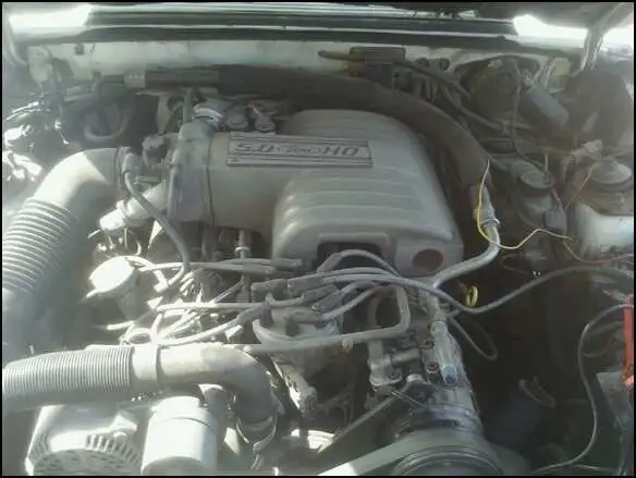

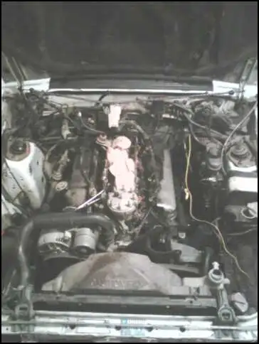

as it sat in my sisters yard
and after it got home with the ac and upper intake manifold removed

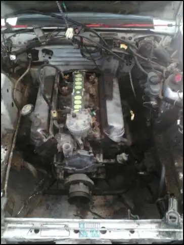

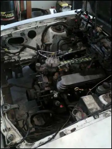

then the acessory drive components came off
then the radiator and h-pipe (not pictured)

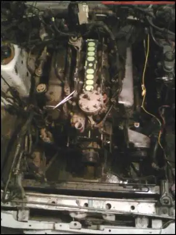

Here it is, ready to come out. All bolts have been bagged and taged. All wiring has been marked with color coated tape. Some wiring has been removed, like the oil level sender and the O2 sensors. They wont be needed when I am done. Getting a new starter cable assembly, the old one is caked with so much oil cleaning it is not an option to me. As you can see in the photo the whole drivers side of the engine bay is caked with oil, so that will need to be cleaned. Everything will be cleaned and replaced as need be before I even start work on the engine. I will be putting an off road X pipe on it and want to remove the smog pump and all that crap but I dont know if that will interfere with my vacume. Any help there will be appreciated. Other than that I am on my way to a TOTAL restoration. With a decent list of upgrades in mind. But first the suspension.
Thanks for the advice. :nice:
