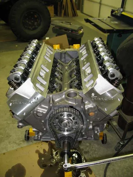

I think I've decided on the trick flow 170s. I should be able to use a decent cam without having to notch the stock 5.0 pistons.
does anyone know the difference between these two part numbers?
Trick Flow Specialties TFS-51400004 - Trick Flow® Twisted Wedge® 170 Cylinder Heads for Small Block Ford - Overview - SummitRacing.com
Trick Flow Specialties TFS-51400010 - Trick Flow® Twisted Wedge® Track Heat® 170 Cylinder Heads for Small Block Ford - Overview - SummitRacing.com
they are both 61cc, and both have dual valve springs good to 0.600" lift

I sent them an email, but looking through their website, it seems the differences are:
the 004s have 3/8" rocker studs and the 010s have 7/16 studs.
the 004s have 7 degree locks and the 010s have 10 degree locks.
the 004s are CARB compliant and have a "heat crossover" while the 010s don't.

from trick flow:
"There is no performance advantage from on to the other. The 51400010 just does not have the smog ports and it comes with the bigger rocker studs."
Both are the same price at summit. I'm not going to be using a smog pump and my '65 will never see emissions. Which ones do you think I should get? It seems to me that the only reason to go with the 004s would be resale.

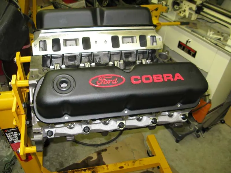

Well I finally got some parts together and started on the engine. So far everything has gone well, except for my valve covers.
Exactly how important are the baffles? I really like the covers i have but the baffles are making contact with the studs. The valve covers were advertised as being "tall" but they sure aren't fitting.
the side with the baffle is about 3/8" off of the head.
PoppyMod
Jun 27, 2010
617
Severna Park, MD
Mar 3, 2011
#30
  • Mar 3, 2011
  • #30
Hi,
That's some nice looking junk you got going there. I too, had baffle conflicts. So, I removed them a when I put my junk together (2009). I did grind down any casting bosses that were present on the underside as well, just to clean it all up.
I run screw-type breathers (one with a built-in PCV) with dbl gaskets and have not one leak from these V/Cs. (cast Mustang powered by Ford)
As you can see I'm running CompGold rockers, with studs on TW heads, as well.
Unless there are some other dimensional differences, you should be good.
Good Luck!

Thanks.
I have the baffles cut out now, and the covers now fit on the engine. I'm going to try a set of grommets with built in baffles and see how they work. Summit has their own for $1.50 each. If that doesn't work I might build my own low profile baffles.
