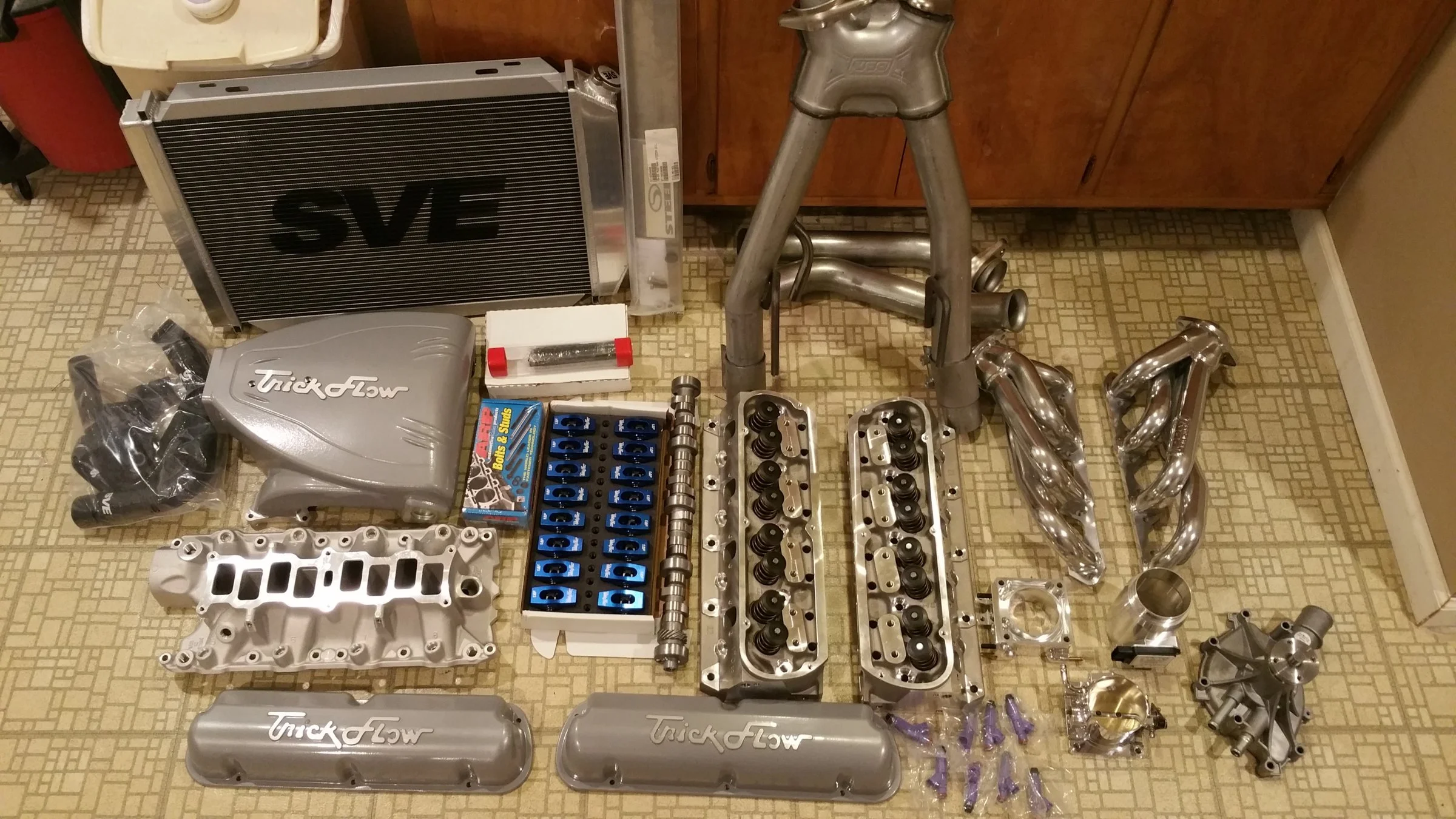

I went with the Trickflow kit and all the supporting mods, which I'm currently right in the middle of doing. 4,200 bucks for everything pictured and that was on sale during black friday. It seems supercharged or turbo's give you alot of bang for the buck, but I'm old school ( not to mention old) so I went top end.
Hope you also bought a new SFI approved balancer
What MAF are you running

BBK 76mm billet for 24 lb injectors, accufab 75mm throttle body.
