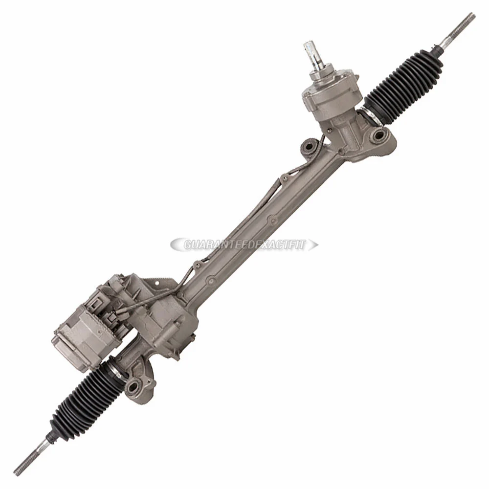

They provide an electrical assist to a manual steering setup.
Nobody uses that. It's a pain in the ass and gives you the SUV feel. It looks like most folks are putting in a potentiometer and adjusting the force feedback manually.
So all I got to do is find a totaled GT350 then?
Hummmmm......Nobody uses that. It's a pain in the ass and gives you the SUV feel. It looks like most folks are putting in a potentiometer and adjusting the force feedback manually.

Bmws have EPS...You can bet that the loyalists btched loudly when they made that choice.The steering in our cars change in quickness and effort when you switch between comfort, and sport. Since BMW made the change, only the dyed in the wool purists still btch.I read little more last night about some of this. It appears that most folks are quite happy with adjusting steering feel manually.
Having driven a '12 X5 w/ conventional hyd power steering, it's plain to see why they did it. It was a heavy, medium effort steering feel...They are courting the female driver now,...With EPS, steering a 5000 lb SUV can be as easy, or as "in touch with the road" at the touch of a button.
It saves significant weight, and reduces power drain as a result of one less belt driven accessory.
