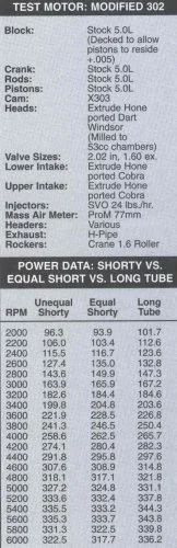

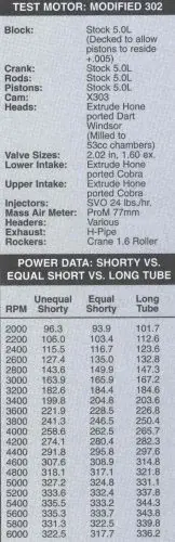

check this out!
looks like some shop hand getting paid minimum wage got the 2 confused? I remember seeing many dyno testing in the older 5.0 mags(when they were full of good 5.0 info not mod shmod crap.Gotta dig em up,now im curious...hummm
Agreed. Back in the day when I was researching this stuff, the equal lengths consistantly out-performed the unequal lenghts. It wasn't by huge numbers, maybe 7-15 hp at peak, but enough for me to go with ceramic coated equal lengths at the time.
