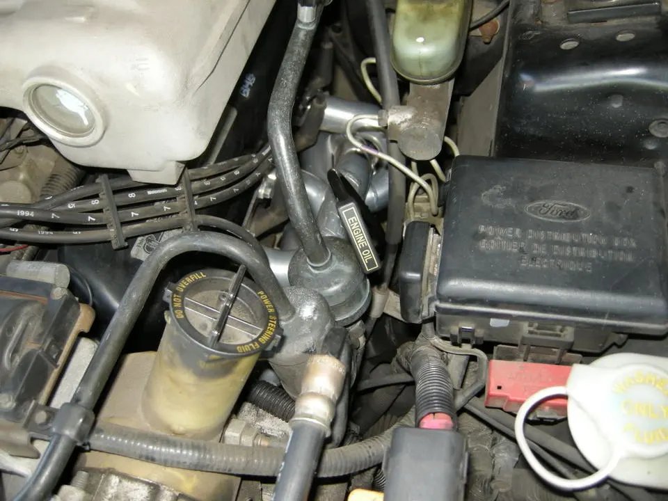

Just bought a 94 GT and the previous owner installed equal length bbk shorties, but did not put the dipstick in correctly. Is there anyway to bend the stock dipstick around the mass of bent tubing of the equal length headers?
Have any pictures of your dipstick with the equal length headers?
i hated the EL headers that were on my car when i bought it. they burned plug wires and i also had the dipstick problem.
mine were bbks too. i got rid of the headers
Oh yea its a major pain. I was able to get the dipstick back in, but i cant seem to get the bracket on the dipstick tube to stay on the header bolt. I will probably just zip tie it down somewhere.
When money allows i'll be putting the equal length headers up for sale and getting some "regular" shorties. It was a pain in the a$$ doing a tune up yesterday.
I have mine zip tied to the brake lines on the master cylinder. No problems, except for my strut tower brace hiding the dipstick! I could just see the oil change place trying to find it! (not that I take my car there :) )

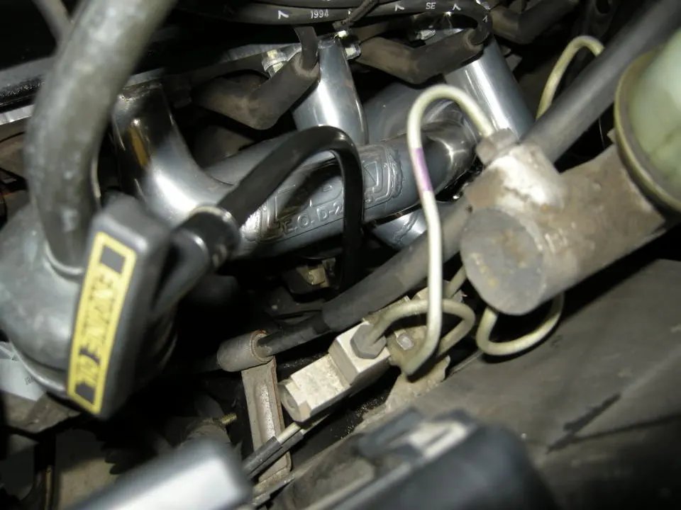

I have never had burnt wires and the stock dipstick bracket can be bent with plenty of clearance. It attaches to the #7 bolt just as with stock headers. There is about 1/4" of clearance over the BBK plate on the #6 pipe.
attachment.php

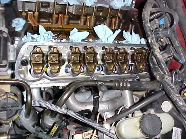

And before anyone comments on using stock rockerarms on aluminum heads just know that I am on a budget and buy my parts when I can justify them. I currently run Crane "Cobra" 1.7:1 roller rockers :)
The #6 sparkplug is the only one that is tricky because of the dipstick bracket.
Just put the socket on it first and then attach the ratchet on the socket. That way you don't have to loosen the header bolt and move the dipstick bracket out of the way.
