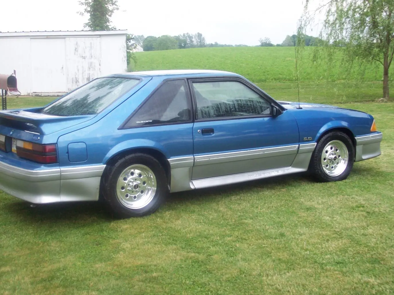

I run a 275/50r15 ET Street on a 15x8 draglite with 5.5 rear spacing. No rub on the outside at all and the quarter panel is untouched. The inner however required a little adjusting but not too bad really. No quads.

These tires aren't radials but it should be similar in size. We have identical cars/wheels btw
