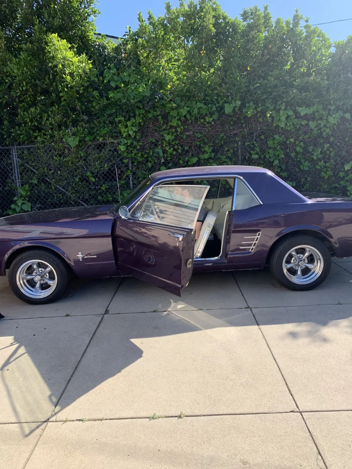

Hello everyone! I'm Robert. Just bought a 1966 coupe with a 302, 4 on the floor/ 650 demon carb! She's purdy! Excited to join the forum and gain invaluable information from everyone's years of experience and hopefully I can help someone along the way as well. My first order of business is power (assist) steering and a front disk brake swap. Anyway feel free to reach out, happy to talk mustang anytime!
