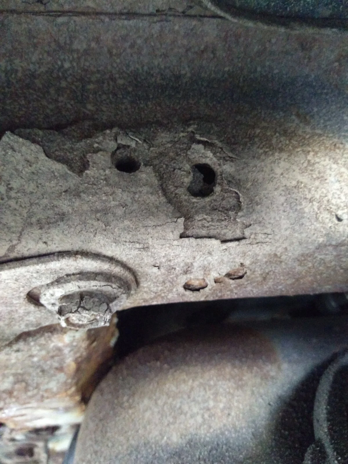

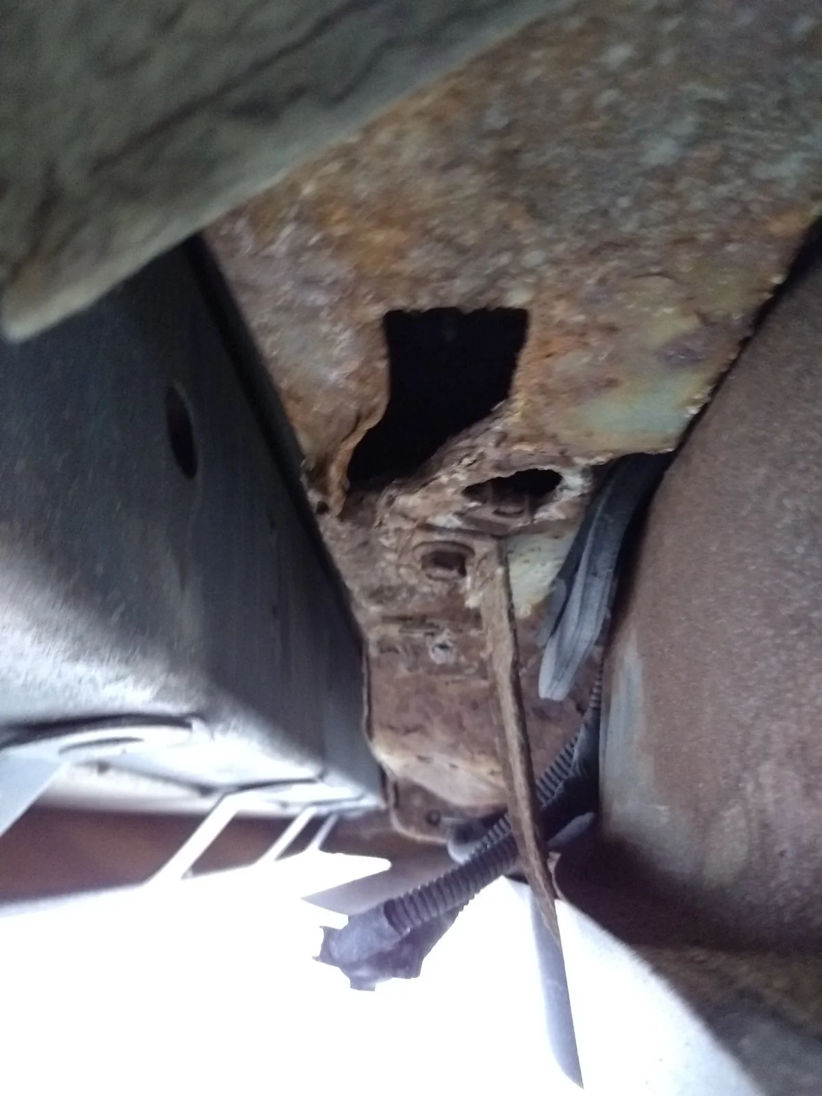

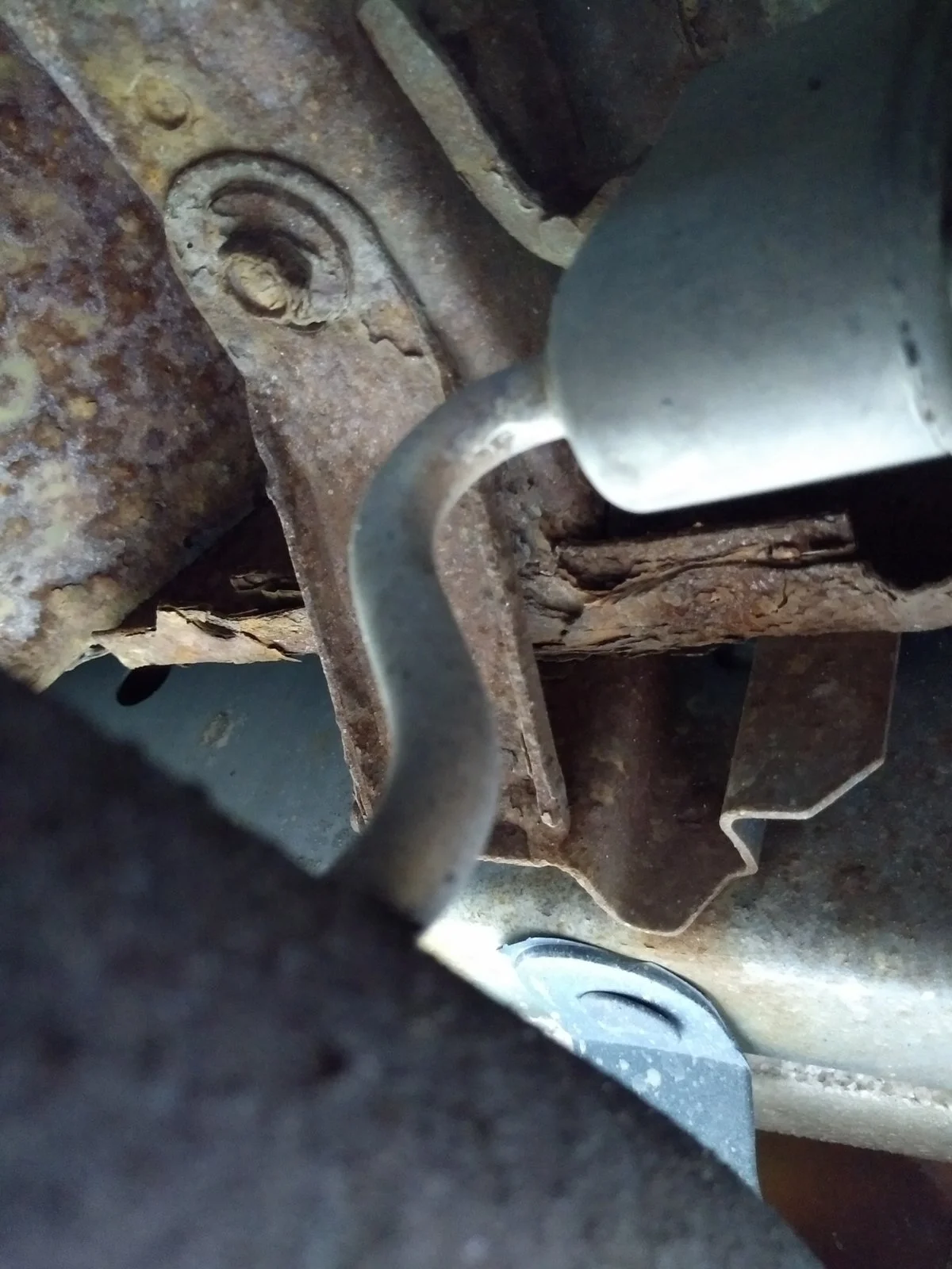

Hey, just an update - I was looking underneath the rear to see if it had the spots I'd need to install the extra hangers and I notices the rear part of what I guess is the frame seems pretty rotted. I'm kind of afraid to do this mod now. It would be kind of expensive and I'm not sure how long this is going to last. What do you think? Am I worrying about nothing, or would putting too much money into this car be a waste?
Ok, here is my two cents worth.
the frame structure on these cars are the most important part, rust damage that is showing is not good and I suspect there is more in other places. As far as is it worthwhile to add exhaust to this to me would not be a good investment.
unless repaired it will only to get worse.
