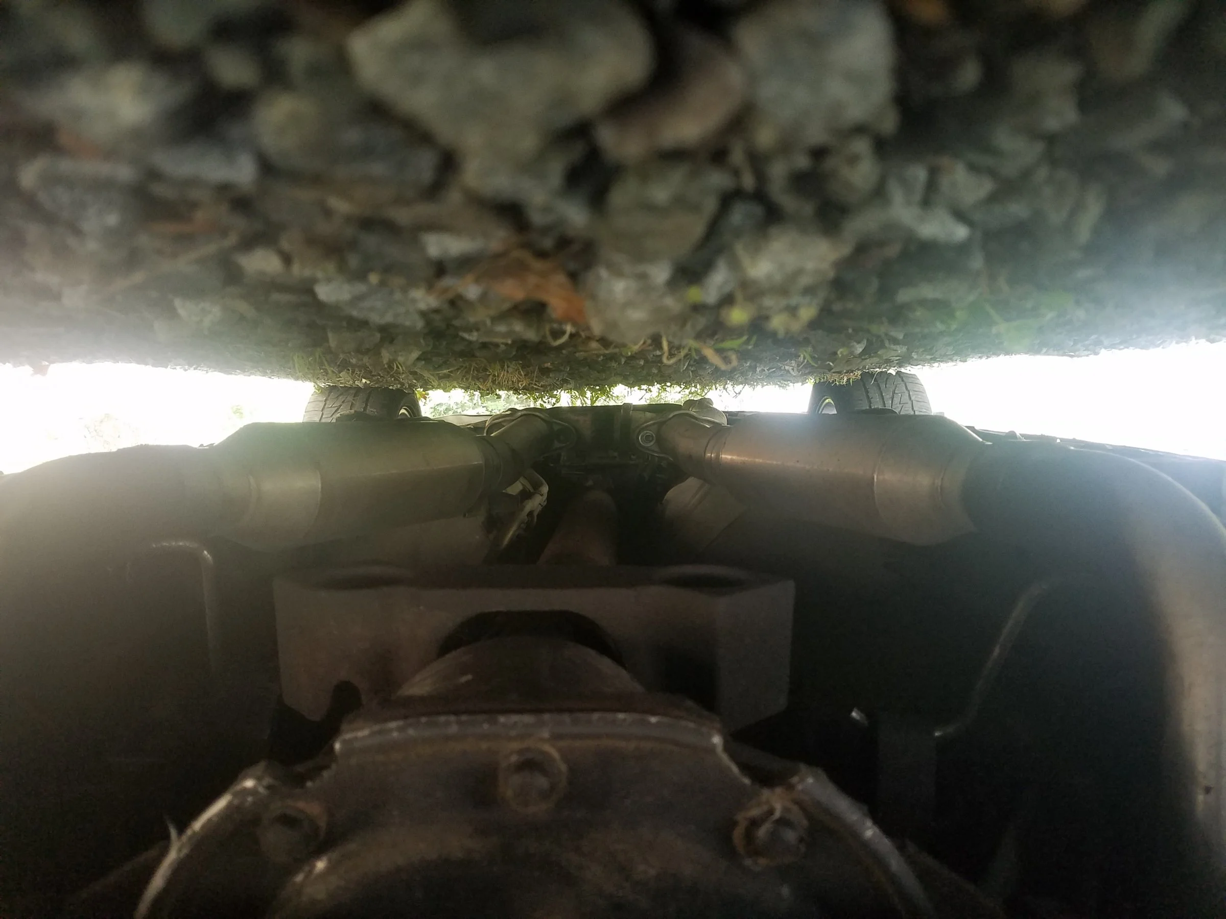

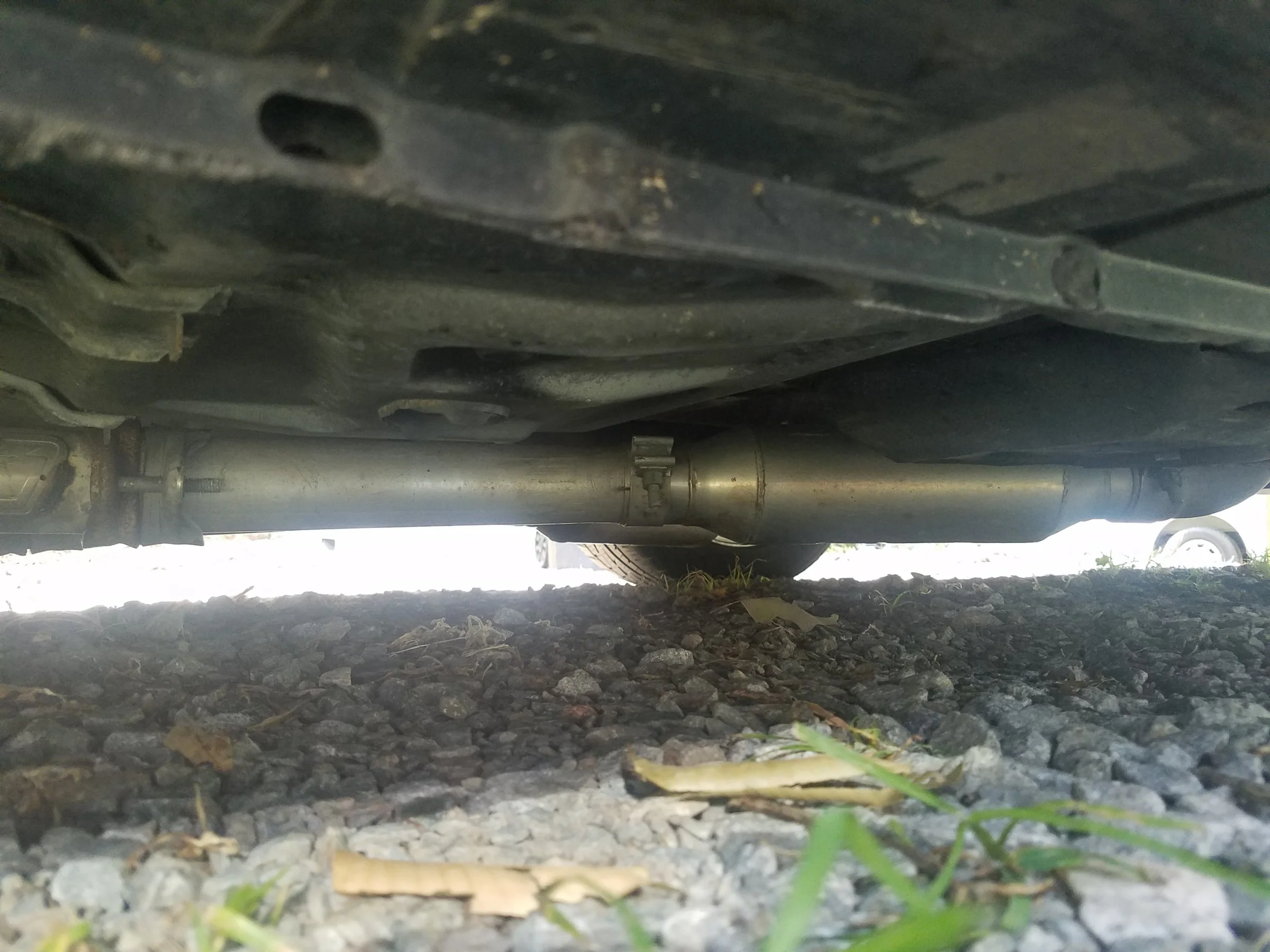

I was wanting to get the Flowmaster 44s, but here are some pics of my exhaust setup now, I'm pretty sure it will fit with welding. I have SLP resonators on here now

Find out the inside diameter of your piping. Make sure this is the inlet/outlet size of the mufflers you order. This will make install easier. My recommendation is to replace the resonators with the mufflers. This will depend on how much space is at that point in the system. Also, keep in mind the varying lengths of mufflers. That will also be involved in determining what part number will fit.
It's all good now guys, thanks for all the info. I bought the 44 series and got my local muffler shop to weld them in place with a few minor modifications to get them to fit. They sound awesome though
