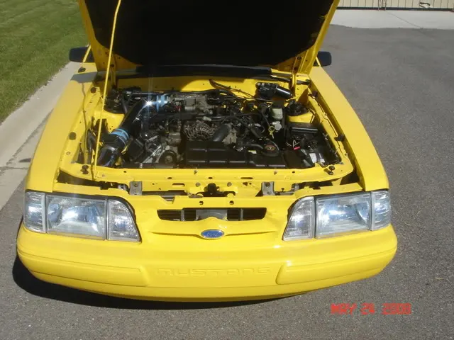

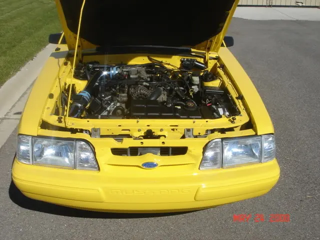

Here is my notchback with a 2001 4.6L engine, stock manifolds, BBK o/r H-pipe, and MAC 2-1/2 cat-back with the big 3-1/2" tips. The donor car I bought was a 2001 GT with L/T's, Pro chamber, and this same catback....I got rid of everything but this catback....and in the donor car it was much quieter.
Before car was done...excuse wheels and no front bumper...lol
On dyno...inside car...and yes....that's a 2001 dash swap too.
On dyno...outside car.
PIC to prove I have a 4.6L in my old notchback
