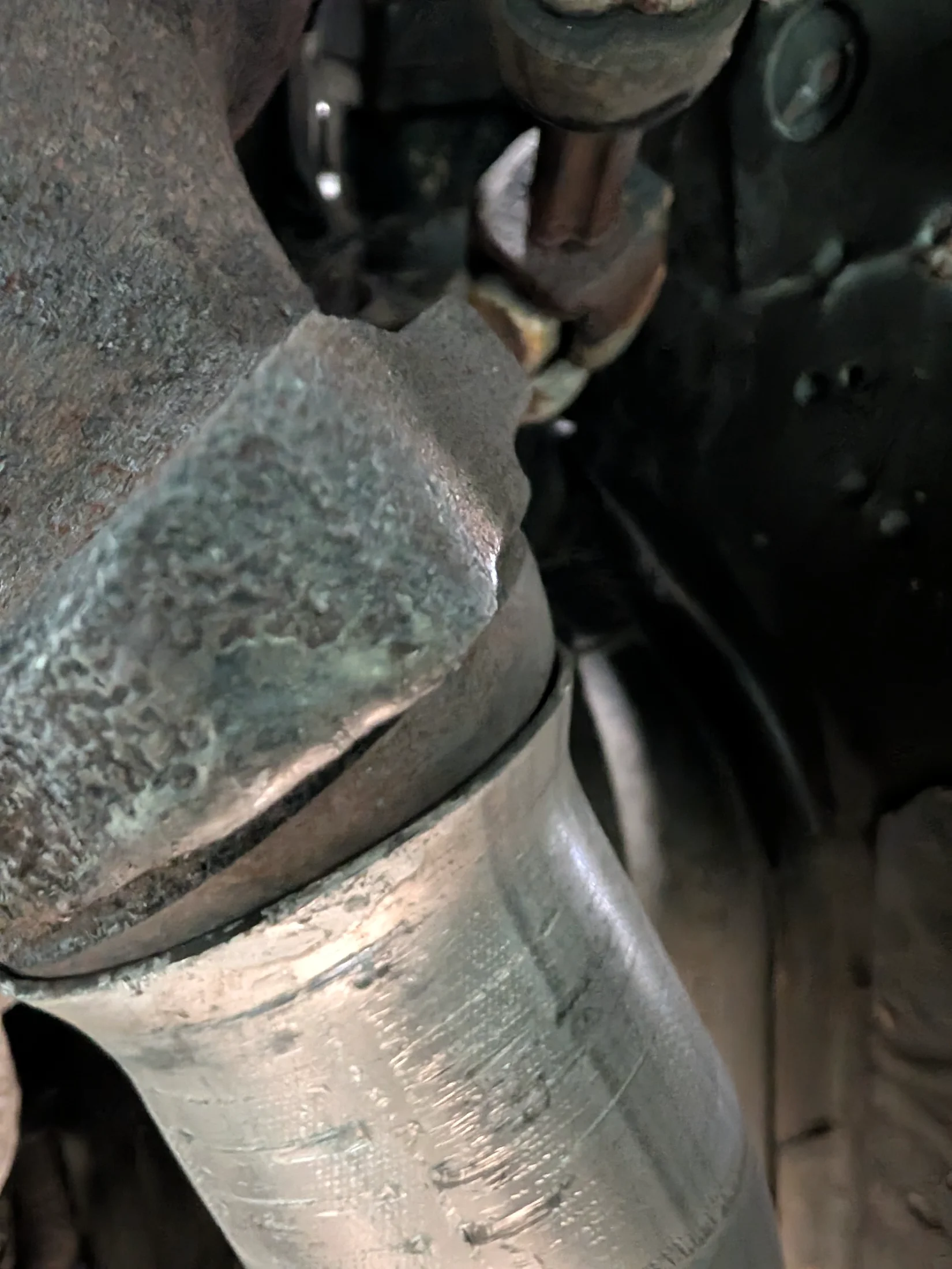

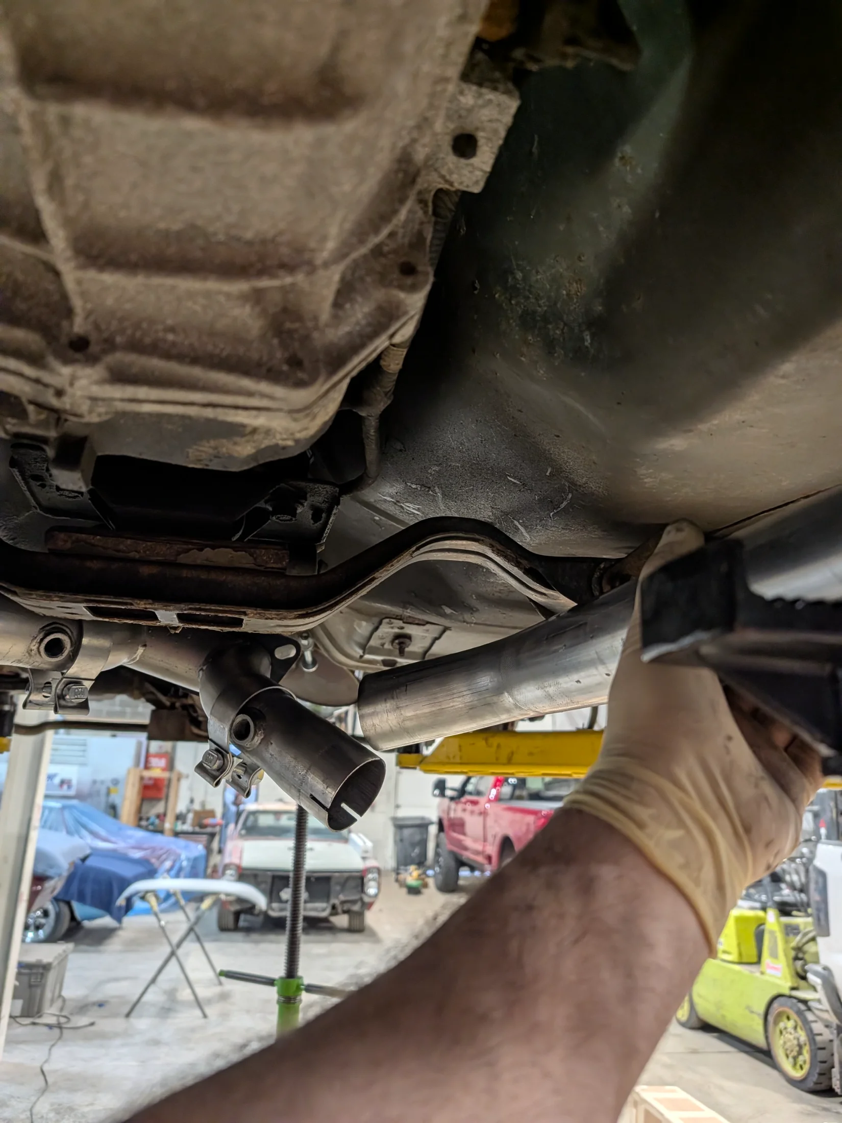

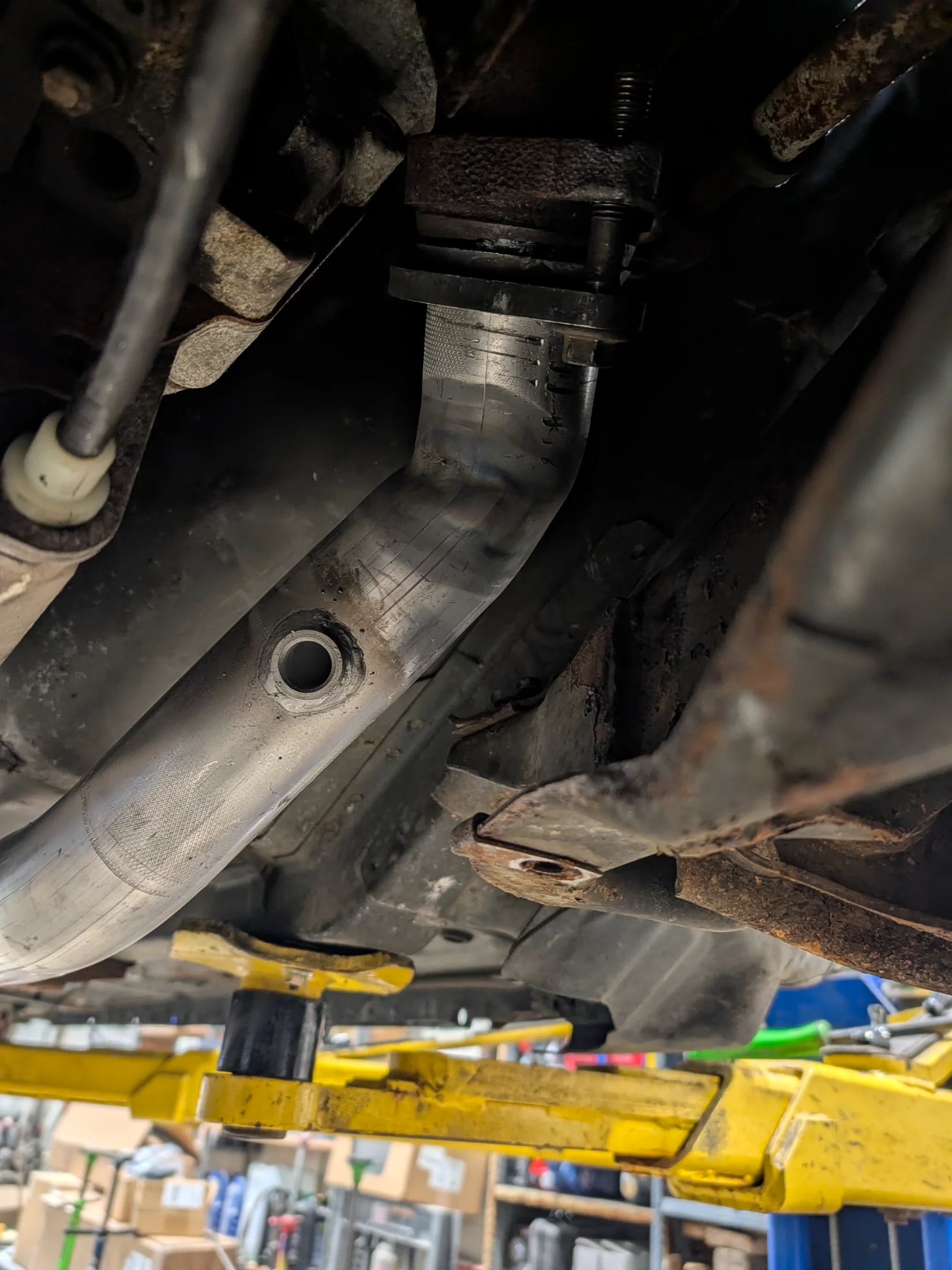

Ok so went to install it today....Doesn't fit.... The left down pipe is bent wrong, almost like it turned in the jig or machine between bends...
If the socket lines up with the manifold the back is pointed down. And if the back lines up the socket won't seal on the manifold.
The socket itself is pretty shallow so it will need as much contact as possible not seal anyway..
I reached out to the place via their contact form on the Web site... we'll see if I get a reply...
It should be an fairly easy fix if I slice a straight section and rotate it then use a band clamp and/or reweld it but I want to see if I hear back before I start cutting
I did try to heat it and re-bend it behind the socket but couldn't get it to go

That does look like they setup the Jig incorrectly. Seems to be an easy enough fix with a chop cut. You could cut it yourself, rotate to where it would fit, mark the pipe and have someone weld it back (or you if you can weld) easy enough.
Well they never got back to me.

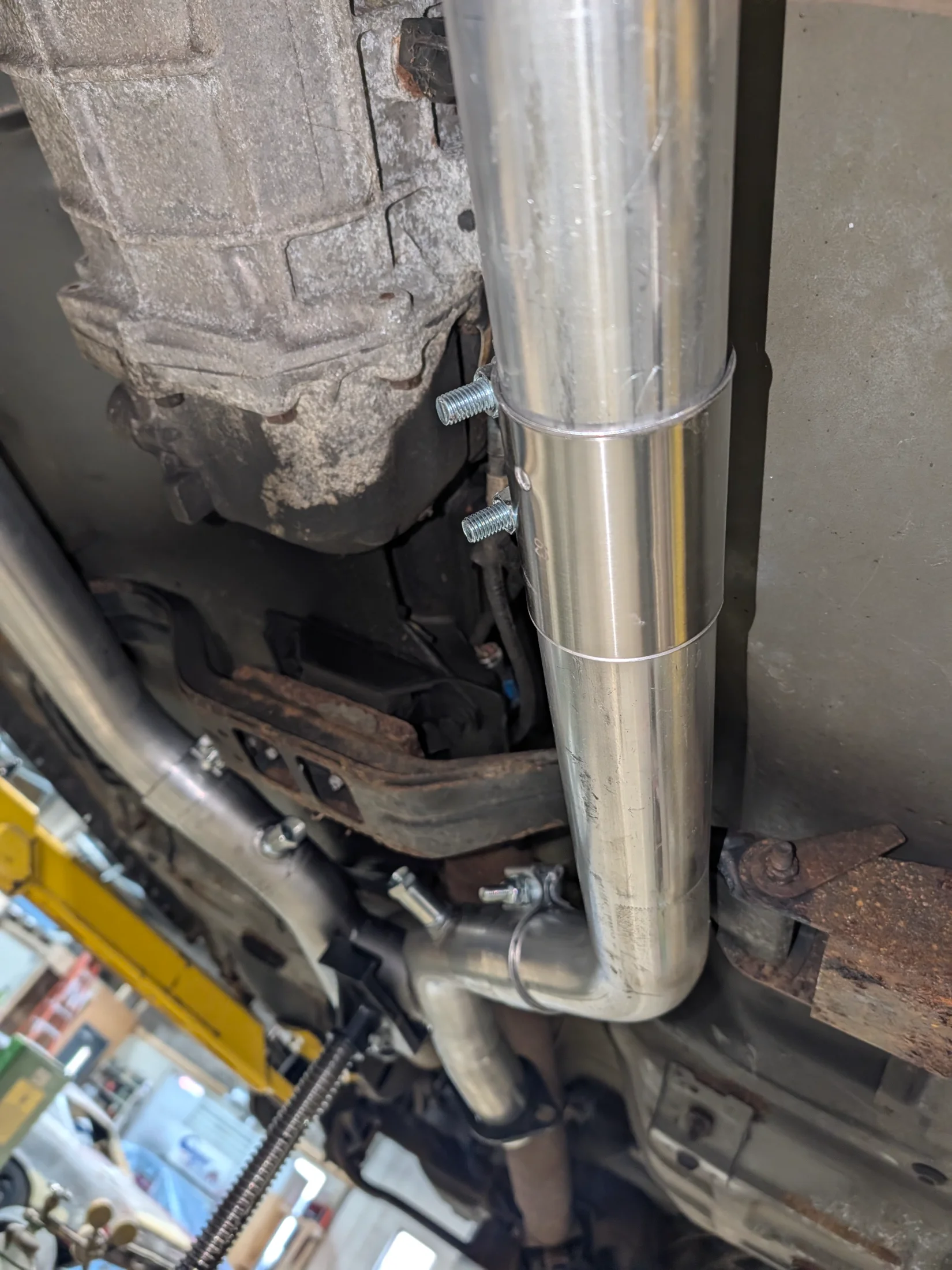

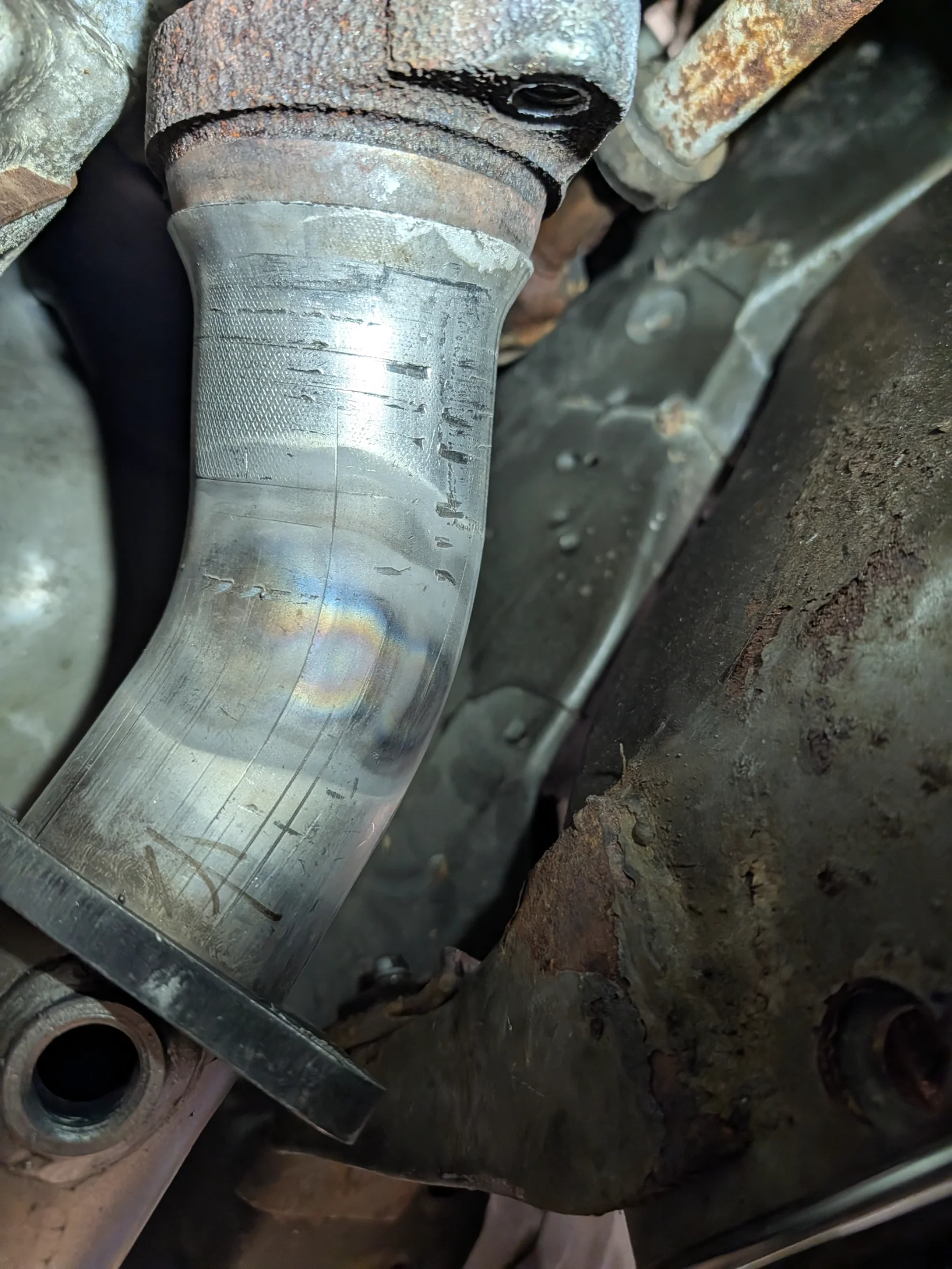

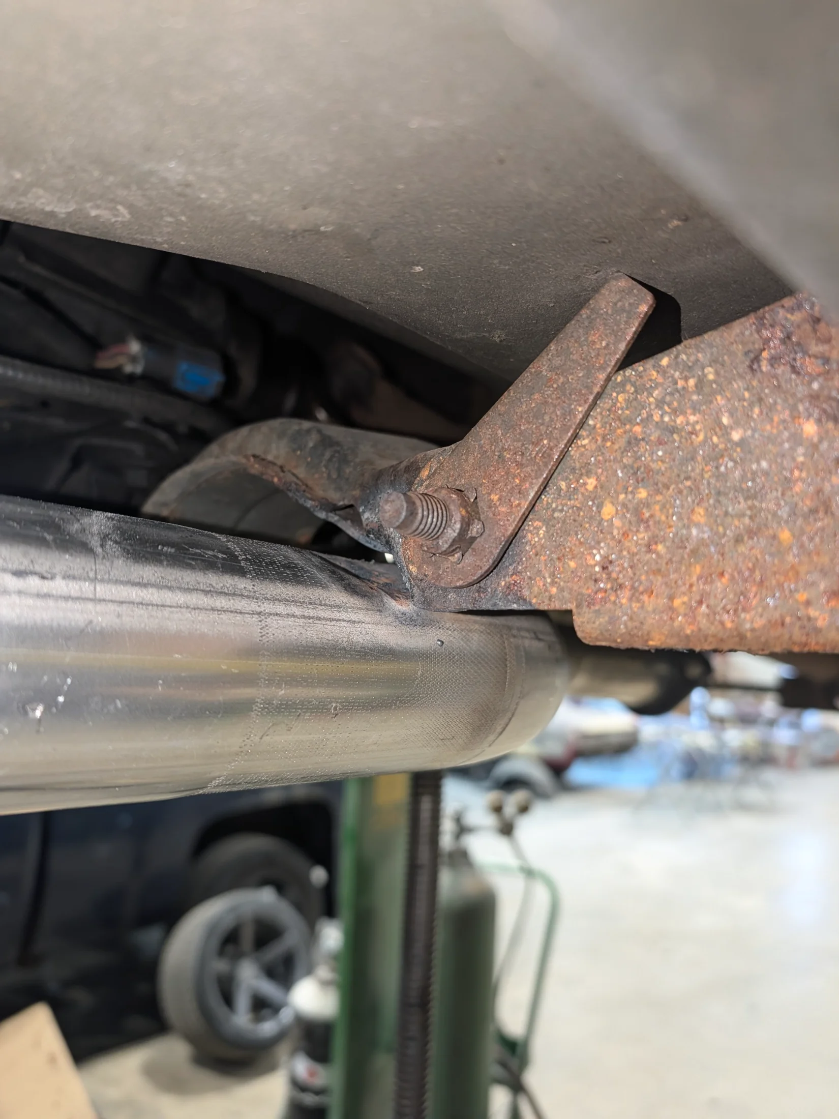

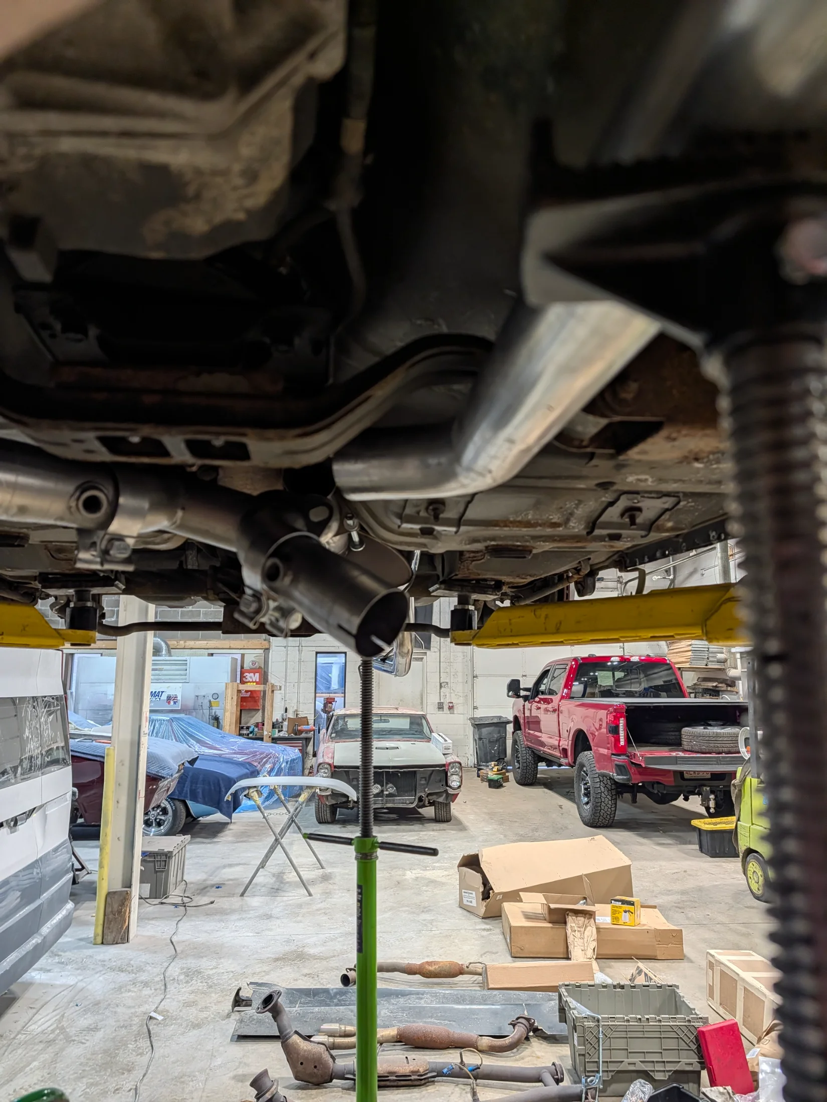

I installed it this weekend, one cut and one re-bend and it went one... Fit is still mediocre but for the low cost I guess what I get.
Bolted the left down pipe on so that the socket was seated properly, made the cut and realized it still had to be bent in towards the center of the car...heated and rebent, it's not pretty but it's fine (much easier with it bolted up rather than in a vise) and some clearance adder for the trans crossmember
Overall it fit and doesn't leak...id spent the $$ for a better one next time however
