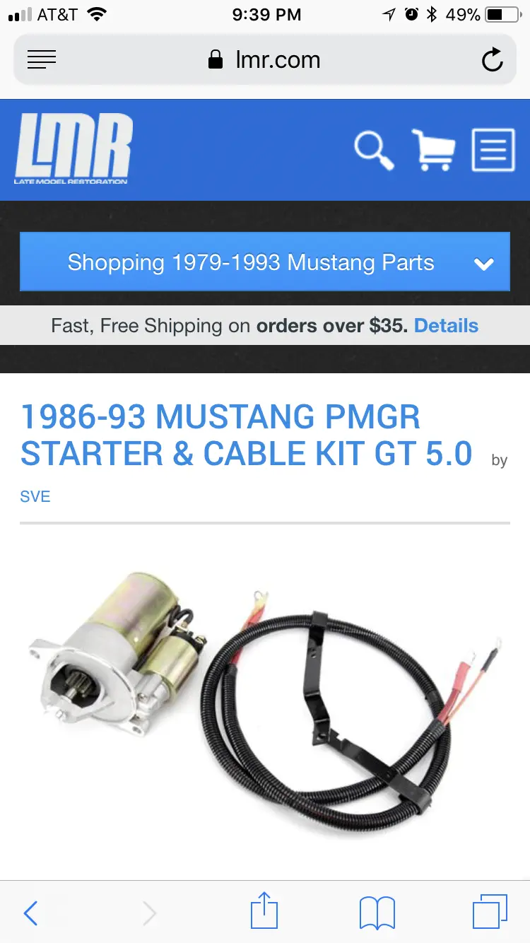

Nice def gonna get ceramic, and I was going to actually swap over to the SVE mini stater which is just the same as what came in the 92-93s, did you change your cable for it?

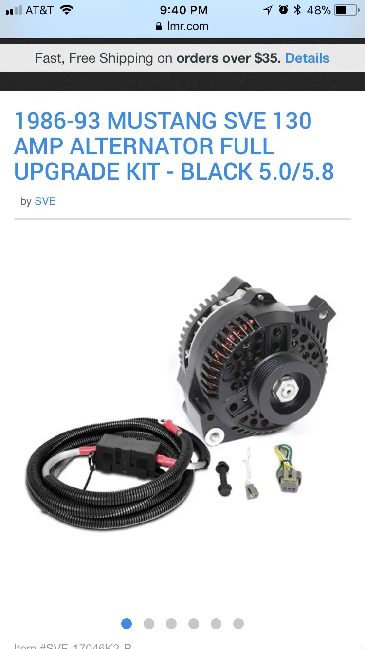

Ya, I took the starter harness from a 92 I had but I'm up grading to 3g and going to use bigger cable to the starter, they're kinda puny. You can jump the solenoid with a short wire on the starter,
Wait what do you mean? So I’m looking into doing the same. Was going to end up grabbing these two items, so what is this jump you are talking about. Could I go to say autozone and get the starter harness for cheaper bc lmr is charging about 100 bucks for it.
