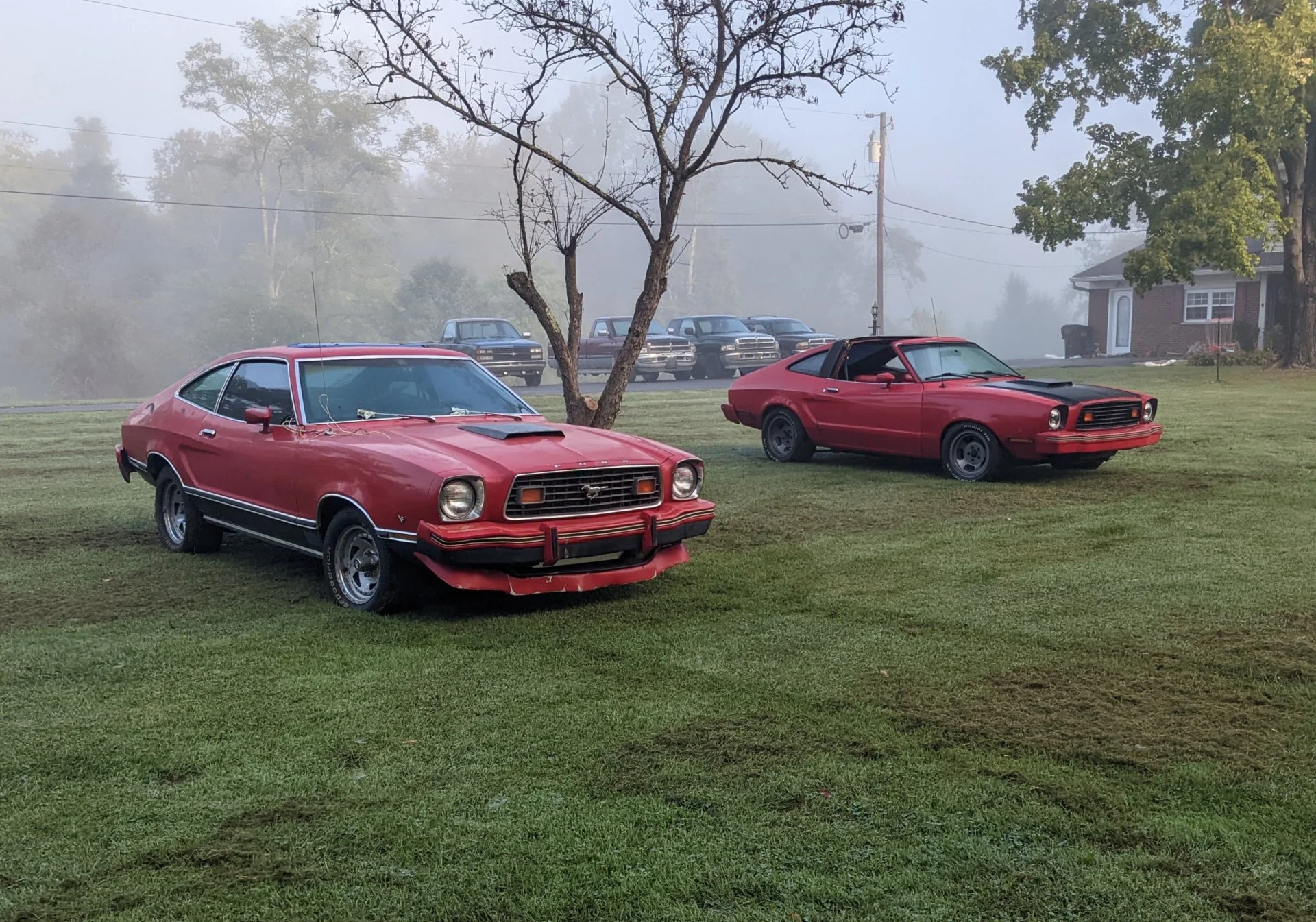

Just a short update as the wheel of Ka made it's way back around to her. Aired up the dry rotted tires. Added a couple gallons of fuel. swapped in the factory alternator from Christine and went for a ride. Kept her under 40 mph and only went a few miles but it is so smooth vs Christine. First gear on the rad4 is tall vs the t5.
I have the crappy wheels at the tire shop now to put the old 14's from christine on them. Maybe I can get exhaust soon.

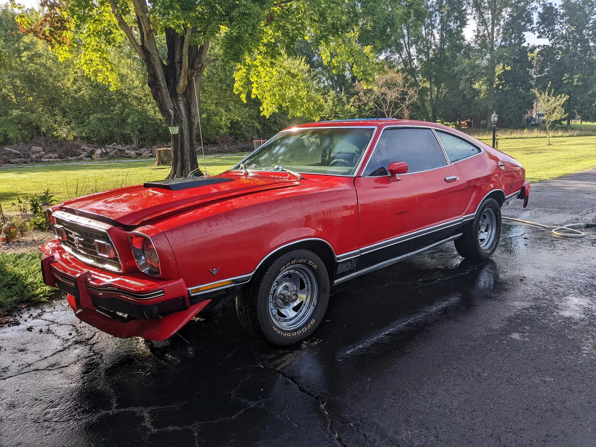

Not much progress but finally have decent tires on her. Drove to the corner and back. Next up will be exhaust then an alignment. At the rate I am making progress that should be accomplished in... say.... 3 years.
