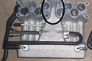

Don't do anything extra; clean the gasket mating surfaces up real good and bolt it together as is. If you get the correct gasket set, there will be some gasket pieces that block the EGR on the head to intake manifold surfaces.
Explorer intake swap; you may not have an Explorer intake, but most of the steps are the same. Skip down to
All other types of intake manifolds and you find lots of helpful information on what to do to make the job a success.
Explorer specific items

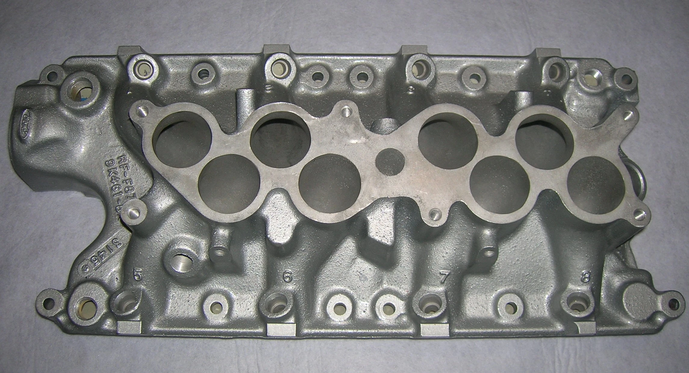

I got mine off a 96 Mountaineer with the 19# injectors and 65 MM throttle body for $250.
The ACT (Air Charge Temp) sensor will probably need to be moved. The GT 40 lower manifold isn't drilled & tapped for it to go into the intake like the stock manifold was. There is a boss cast into the GT 40, but a machine shop will have to drill & tap the new manifold. The best spot for the ACT is the air box if you don't do the drill and tap thing. You get to cut and splice the 2 ACT wires in order to make them long enough to reach the air box. Solder the wire extensions on the existing wires & use heat shrink tubing to cover the splices. Offset the place where you cut the wires so that you don't have a big bulge when you put heat shrink over the 2 wires to cover & protect them. The air box gets a hole (5/8" or so) for the ACT drilled about 1 1/4" down & 1/1/4" in on the front top side near the upper radiator hose. A brass fitting nut from Home Depot or Ace Hardware secures the ACT into the air box.
