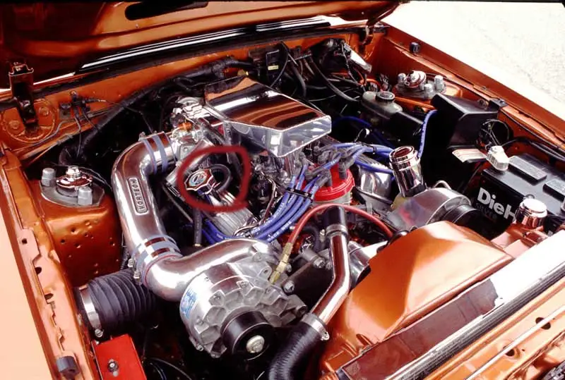

heres a picture of the line that goes to the throttle body. youll see what im saying. circled in red.

ashford said:
staticc i dont think you want that line on the pressure side of the s/c it'll pressurize the crannkcase
ok maybe that was a bad example.
my line is hooked up just as it is in this picture (whoever's engine this is)

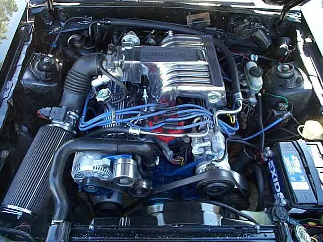

but anyways? why is my igniton ****ing up?

If you wiggle either the + or - cable and can get power to come back, then your cables are bad. What you describe sounds exactly like the problems I experienced when my ground cable went bad.
