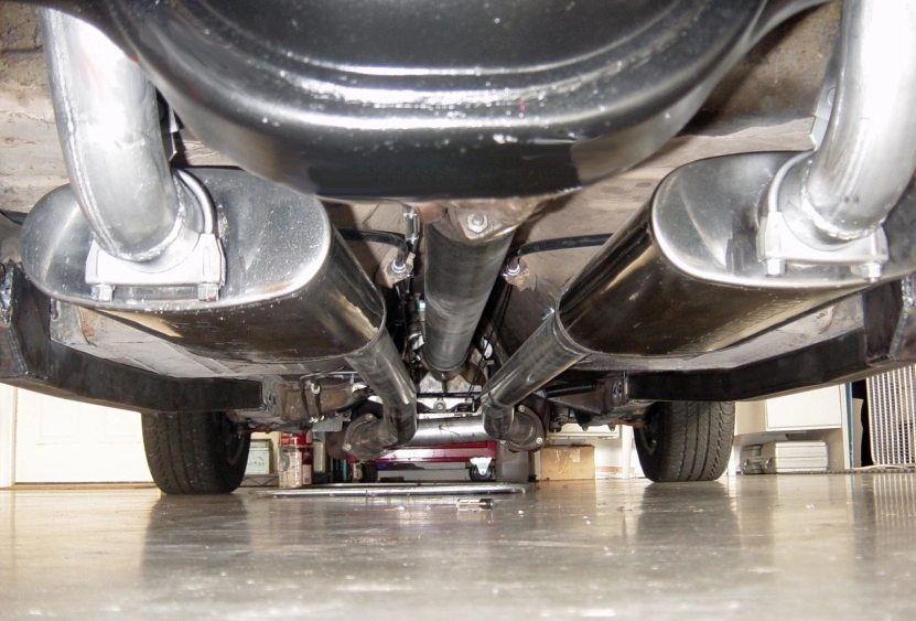

Here's the set I have on my 65. They are made by Tinman Fabrication.

It is all in what you expect. The cheaper subframe connectors that just weld to the end of the front and rear subframes are the cheapest, but give you the least performance gain. The 4 points give you MUCH better performance gain. but usually you lose a little bit of ground clearance and they cost a bit more. Tie them in with a center connecting kit and you have the best pre-fabbed SFC's you can buy. The benefit of making your own is not saving money, but you can make a set better then you can buy.
