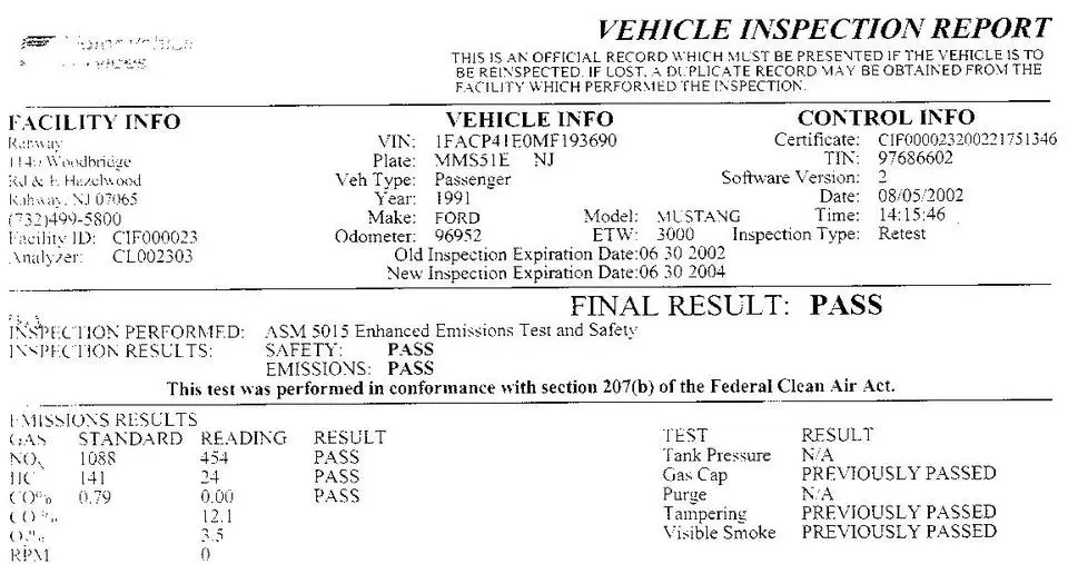

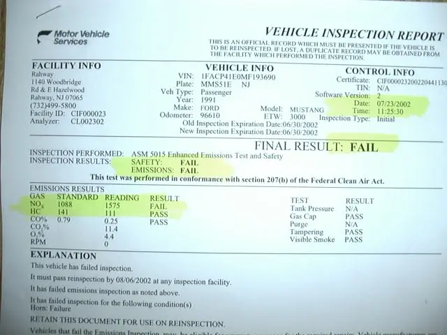

My car failed NOx in NJ many years ago. I got two words for you, Denaturated Alcohol. You can pick that $h!t up in any hardware store. I poured a gallon of it in when I had about 1/4 tank of gas and it passed with flying colors. It lowers your engine's flash point, which means it burns cooler, thereby reducing your NOx. See for yourself, notice how much it dropped other readings as well. After you leave the smog inspection station, just go fill up your car with 91 octane and all will be back to normal.
BEFORE:
AFTER:
