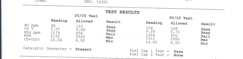

I Failed my Georgia Emissions test today anyone have any ideas. My Wide Band shows in the 15 range at the RPM range. I do have a set of cats on but smog is off

Failed on NOx? Retard timing to about 4* and pump the tires up to about 50PSI, you'll probally pass. If you want to go a little further you might want to make sure the EGR is working. put vaccume on the valve and the engine should die or almost die. If not take it off and make sure it is working and clean out the passages. Also make sure exhaust is getting to the EGR as well.
How to pass emissions testing:
High NO - high combustion temps - retard timing, check EGR for operation.
High CO – Rich condition - fuel pressure too high, check O2 sensors, replace air filter, Clean MAF element.
High HC – Lean misfire, vacuum leak, common misfire due to worn or weak ignition system components. On rare occasions, an overly rich mixture may be the cause. Do the ethanol/E85 fill up as suggested.
High CO & HC - Cat converters, smog pump, and smog pump controls.

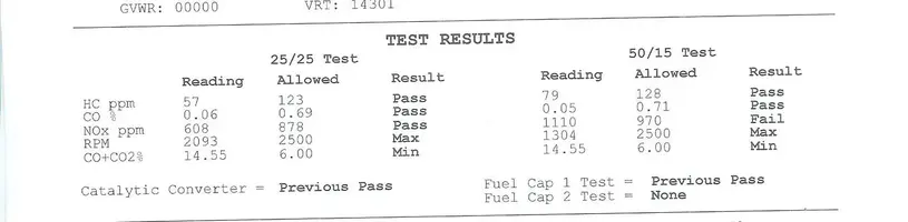

Better then the first just the lower 15 mph I failed now any ideas. The one thing I did forget to do was the tire pressure and I set the timing to 4 to 5 hard to really tell on the old damper.
