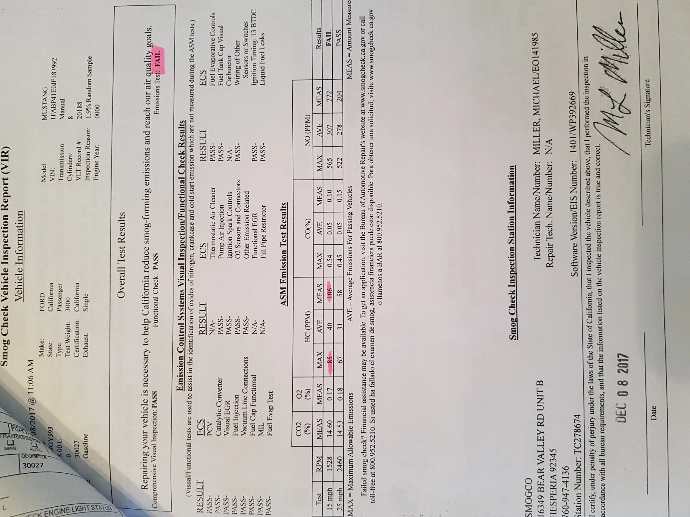

I'm just looking for some pointers on what to replace or fix. I don't know too much about smog but I have never had a problem with the smog test with my car before. Catalytic converters are still original, I have the Trick Flow h,c,i installed. Since it's a 88 in California it's MAF. Also, I pulled No Codes. They said it wasn't that bad but if someone can take a look at the test results I would really appreciate it.

@cliff88145 sorry it has taken so long to get pack to you...
How to pass emissions testing:
High NO - high combustion temps - retard timing, check EGR for operation.
High CO – Rich condition - fuel pressure too high, check O2 sensors, replace air filter, Clean MAF element.
High HC – Lean misfire, vacuum leak, common misfire due to worn or weak ignition system components. On rare occasions, an overly rich mixture may be the cause. Do the ethanol/E10 fill up as suggested.
High CO & HC - Cat converters, smog pump, and smog pump controls. Make sure the smog pump has good air output at 1200-1700 RPM
