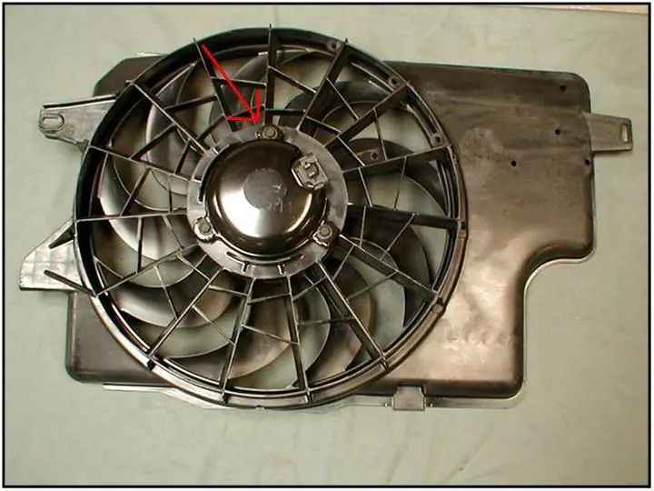

I was heading home tonight when all of a sudden I started to smell something burning. I immediately pulled over and popped the hood and noticed smoke coming from the fan. It looked like it was only coming from one small section, by one of the bolts, I added a picture to show what I am talking about.
**Edit, this is not my actual fan
I unplugged the harness for the fan and I was able to cruise down the freeway for about a mile back home with the heater on full blast and got the temp down from 250 to just under 210. Is my fan done? What should I be checking tomorrow to find out what is wrong?

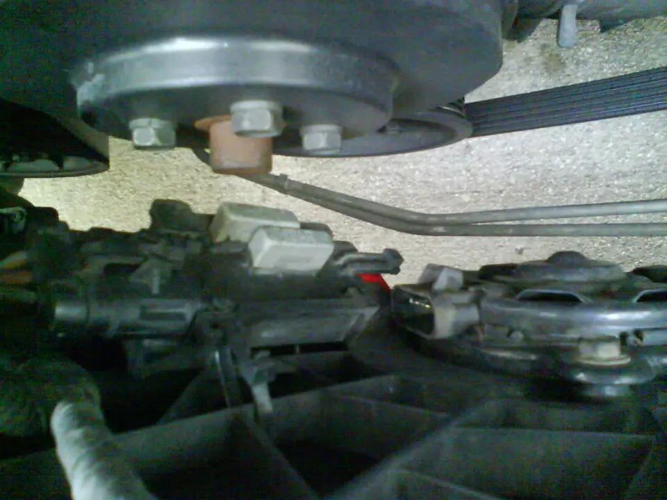

-That's not my fan in the pic.
-The car has had the recall done as far as i know. this is a pic of my fan, it has this connected to the harness...
That bolt off to the right side of the pic is where it was smoldering from.
***I was checking come KOEO codes a few minutes ago for an unrelated issue, and the fan did not turn on like it usually does...

Does the fan blade turn anymore (watch your fingers for sharp edges and don't have the fan's electrical connector connected while you do this)?
Simply sounds like it started to seize. New motors are like 65 bucks or so. You might have issues getting the motor's output shaft divorced from the fan blade.
Otherwise, I also simply bench test them in a situation like that. BE sure to use a fuse if you do this. Start with low and if it works, jump to high (going from off to high really loads the motor up).

The fan will turn by hand with a little convincing. Im not sure how freely it is "supposed" to turn.

The "convincing" is the telltale sign that the motor is dead. It should just about turn by blowing on the fan blades. Even if the fan is off, it should rotate while driving, from the air passing through the radiator. It sounds as if it would not do that right now, correct?

Right, that's what I thought. It takes a good grip on the blades to be able to turn it...
So, does anyone know where to get a good fan motor. Should I just get a parts store replacement.?

The parts store replacement should be a Siemens (a Tier One company). And most of the time they are LLT.
I would not even bench test your old one because my experience is like that which Matt posted (a flick with a finger sends the blade spinning multiple rotations).
You might want to divorce the blade from the motor before you buy a new motor. If they won't come apart (use PB before you attempt it), it might save you buying and returning a motor.
