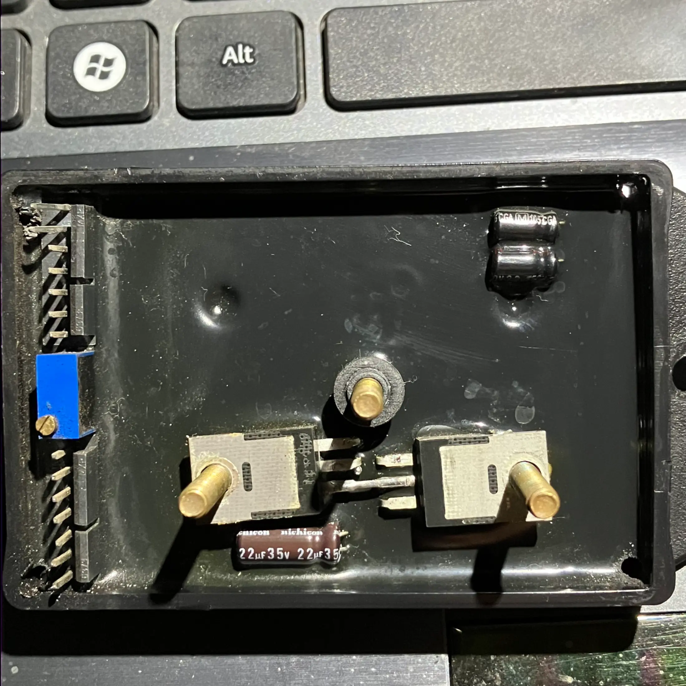

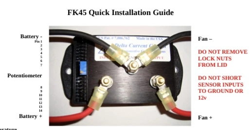

Yes, the first pic is the F45 controller . That plate underneath the whites is the cover or heat sink. The cover has small round insulators around the posts and a rubber insulator in between the the cover and the FETS. Contrary to the typical FETS instalation where the heat sink is ground in these units is positive that’s why the back of the FETS and the posts are insulated from the heat sink and that’s why FETS don’t have heat sink paste on the back so keep that in mind when you disassemble the units.
On the second pic it shows the two FETS under the cover. One of the FETS went bad on me so I replaced it under Brian Baskin suggestion and came out very good.
