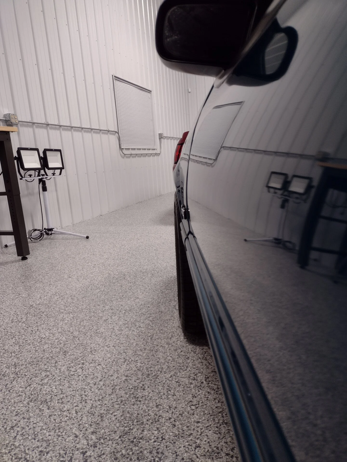

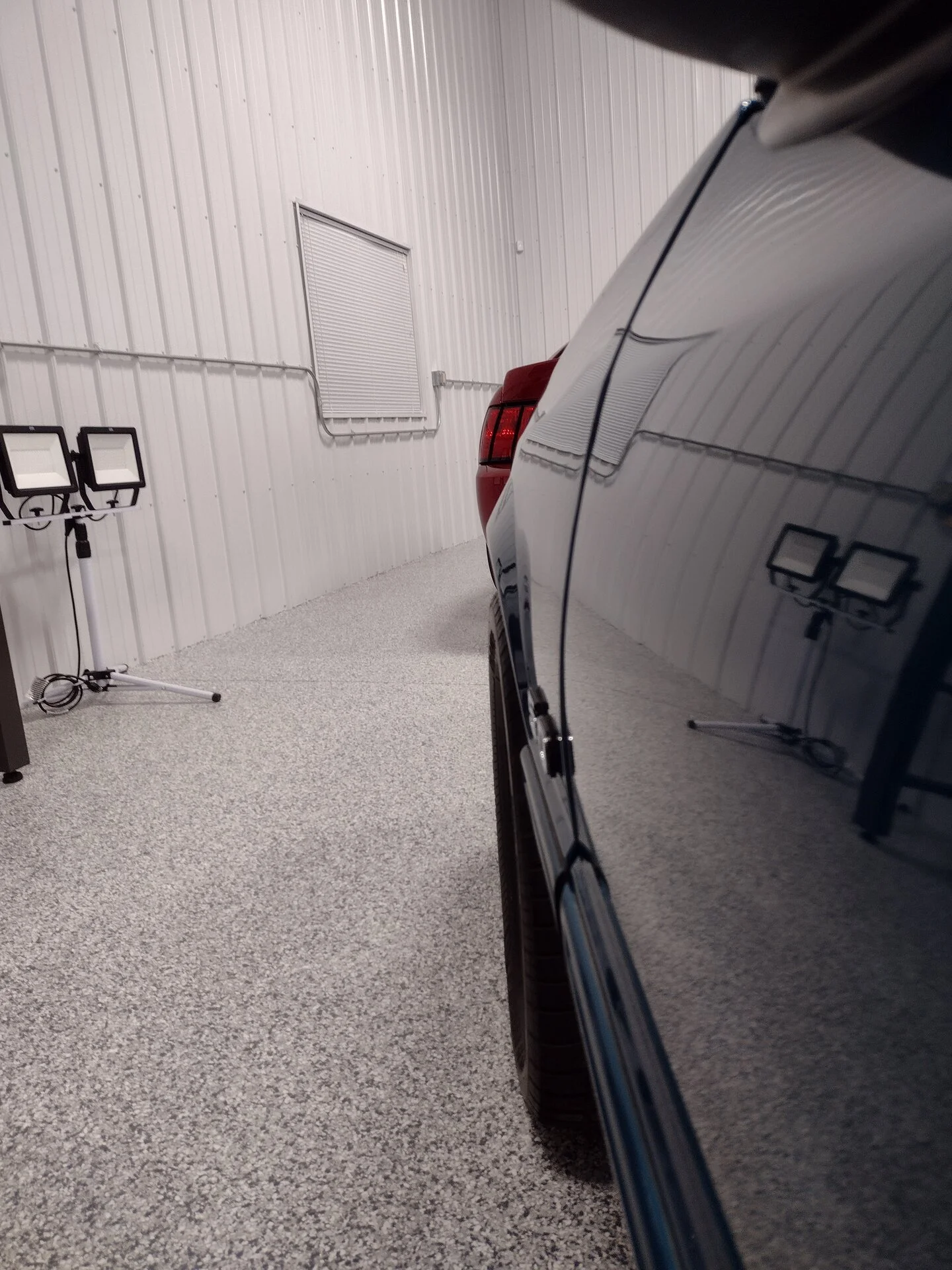

My 93 hatch drivers side fender sits out probably less than 1/8" from the door. I'd like it to be flush.

It is usually because someone at some point jacked the car up on the pinch weld where the bottom of the fender bolts on and bent it. Straighten the pinch weld back out and the fender will pull back into alignment with the door.
That's what I've heard. I'll double check, but it looked straight to me.
I usually just take some big channel locks and bend the pinch welds back straight and that straightens the fender out
So common you would not believe Someone told my buddy with the heavy Cadillac it was normal and for airflow
Good answer if you do not want to mess with it
