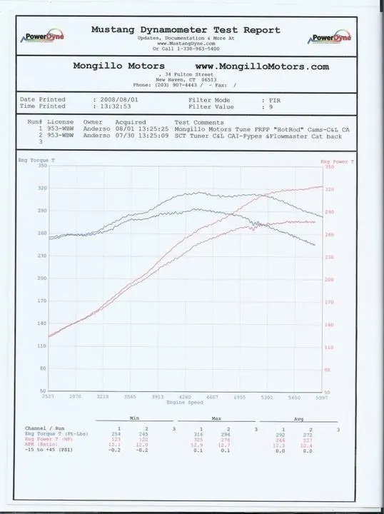

FRPPs don't make power?
FRPPs, lose low end torque?
Comps make more power because of phaser limiters?
Hahahahahaha.....
First of all, our cars have cam phasers to make torque, and Comp is telling people that phaser limiters are a good thing?
Show me a dyno sheet from someone with Comp NSR cams that equals or betters these gains on a cam swap only:
Yeah, I didn't think so.
If you want the dyno sheet for comp cams with phase limiters, contact JDM Engineering. They have the dyno sheet from thier build. It was a 298 3V stroker with the comp cams. They made 401 rwhp all motor on a strre legal package that passed emissions with the comp cams. I'm not going to do the leg work on this one, but if your interested enough, you can do it. My plans are to do the comp cams, and the C&L intake manifold, patroit heads combo. The dyno numbers will be out soon on the intake and the heads. CNLPERFORMANCE.COM

WOW......
Hahahahahaha.....
The Comp phase limiters allow more lift than the FRPP cams are even capable of which makes the limiters necessary on the more aggressive Comp cams to avoid piston/valve collision. If not for the limiters you'd have to lock out the VVT all together. You don't need the limiters or lock out kit with the FRPP cams because they are not that aggressive of a cam. That's why your gains are minimal. Comp only pitches their limiter kit so that your pcm can still ad the benefit of the VVT which like you said ads torque down low by changing the valve timing. These Comp cams are making some real power, but I will admit I haven't seen any dyno comparision of high lift cams with and without phase limiters. The intention of the limiters makes sense though. My only question is, how do the heavier springs affect the VVT which is controlled by engine oil pressure? Will heavier springs adversly affect the VVT? This remains to be seen. Even then, I still say Comp's on top of the 3-valve cam game right now even with the questions.
Exaclt the Comp cams with pahse limiters made all that power on a STROKED...motor with ported heads. We're talking NSR to NSR cams I believe the FRPP's will be better then anyone elses, so far all the dyno sheets i've seen say avg of 40RWHP...good enough for me.
Just to be clear though, I only gained somewhere in the 30s. My baseline pull was only to 6,000 and the final pull was to 6250. It was still making power right until he let off too.
