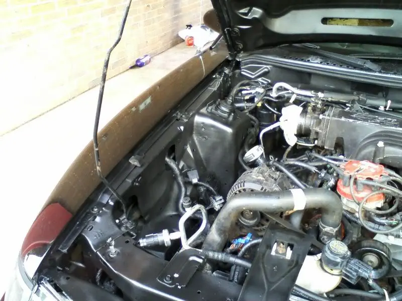

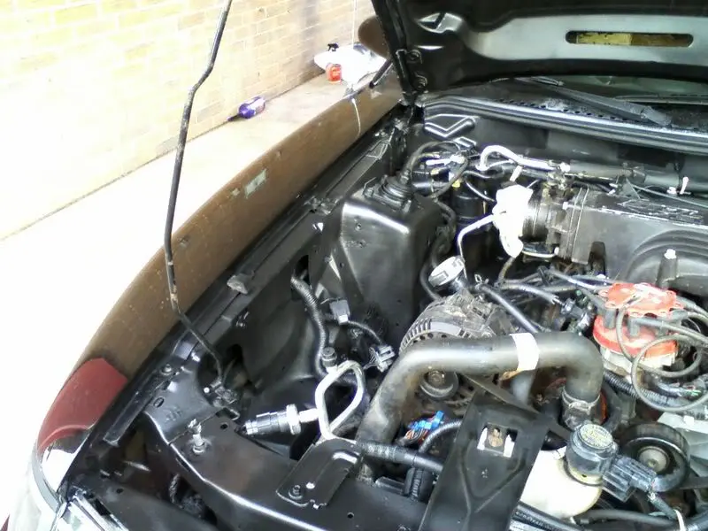

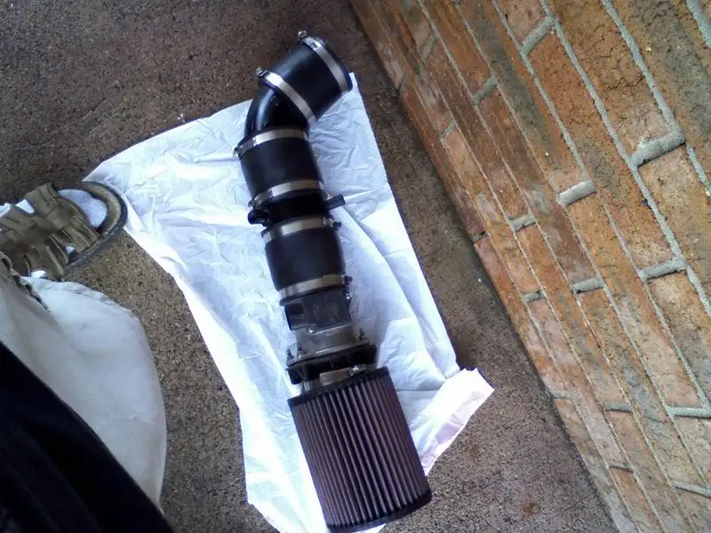

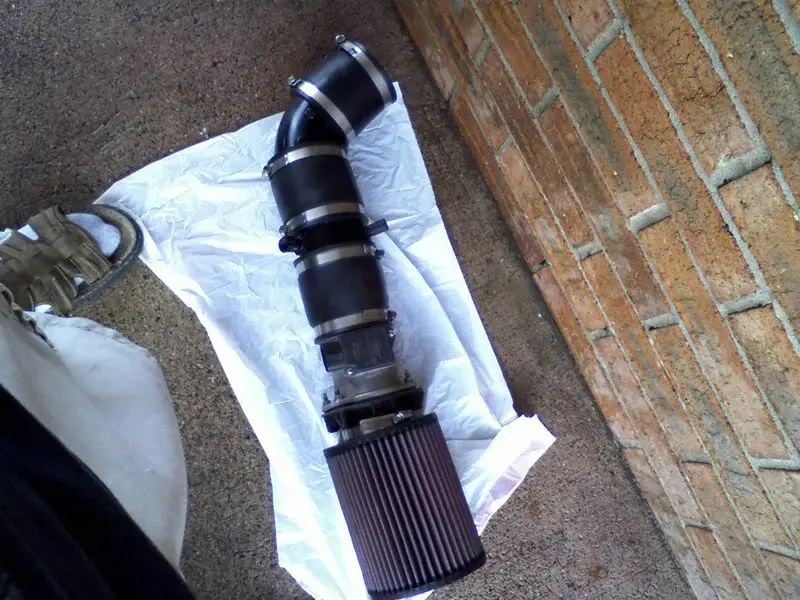

i know it has one too many couplers, but i couldn't find a straight pipe w/ a 90* bend, so i had to couple a straight pipe and a 90* bed together, heh...
keep in mind i'm currently running a fox-style tb setup. gonna change that out to the 94-95 elbow + bbk 75mm tb (thanks, Jimmy).
MAF>filter adapter is the stock piece hacked up--couldn't find one locally or on ebay at the time.
3" pvc pipe and couplers from Home Depot + small rattle can of glossy spray paint = $25 cai goodness
also, bedliner spray ftmfw!! no more ugly green engine bay:
