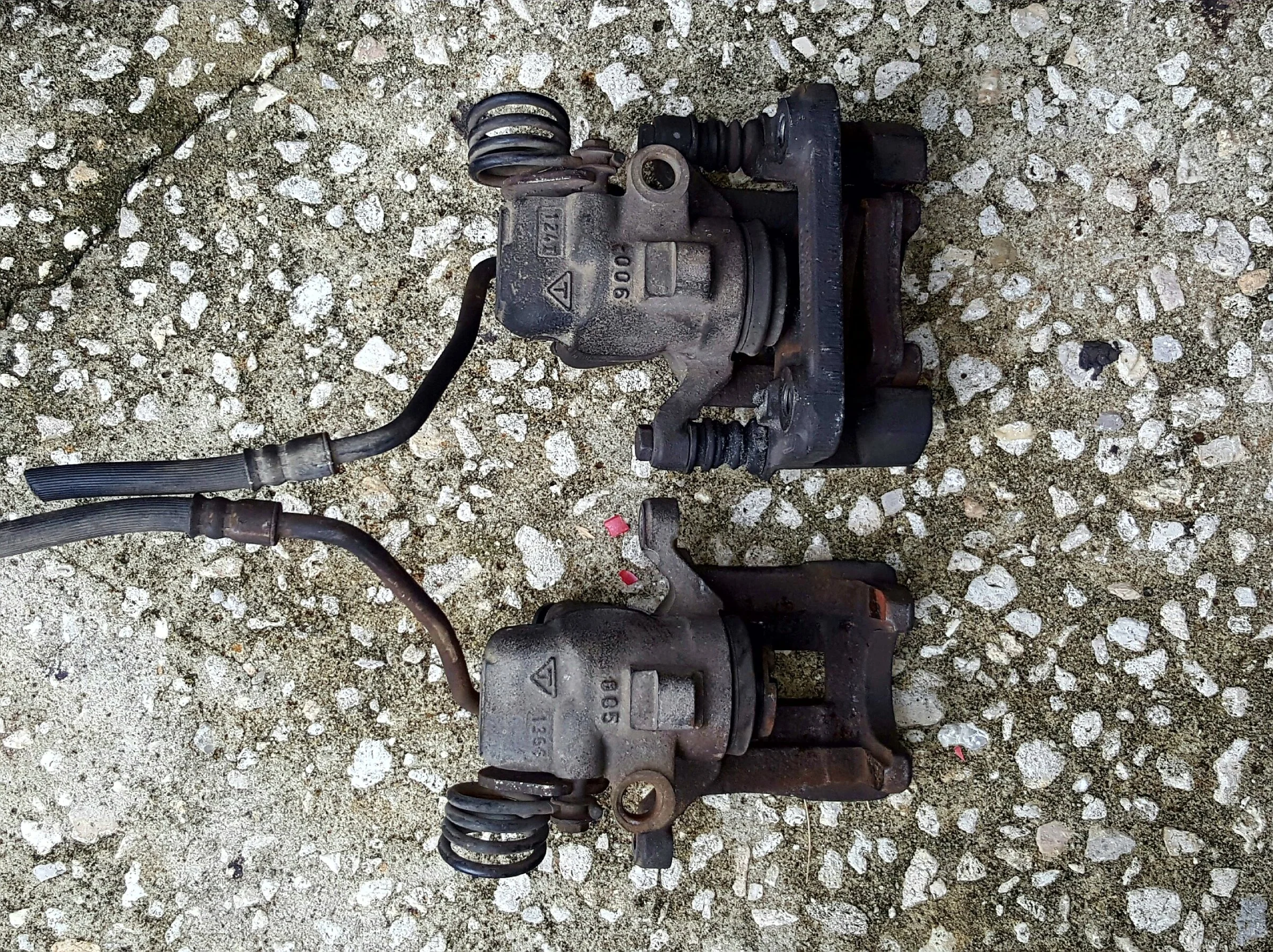

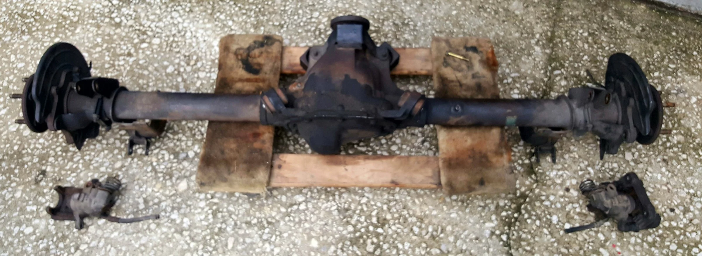

My car was already 5 lug when I got it. I've found out its using 96-98 sn95 front spindles/brakes. And not so sure what it uses in the rear, but it's still drum.
I have this rear now. (Refer to pics)
I just noticed I'm missing half the caliper for the left side. Should I even bother finding just that single part, or just get another caliper?
I'm trying to do this for as low cost as possible. Brakes need replacing, but times have been rough lately. The Stang is my daily driver so down time is a no no.
Also, how can I tell exactly what rotors and pads to buy when swapping the rear to disc brakes?

For the rear setup, looks like a 94-98 setip with GT/v6 brakes. You will need to find that bracket, and late model resto sells it. You also need 94-04 GT/v6 rotors.
Mc and booster need to be changed as well.

Here's your parts list assuming the front brake setup is completely done and you don't need to touch it.
94-04 GT/V6 rotors
1 GT/V6 rear caliper bracket
94-95 GT/V6 Master Cylinder and booster
Appropriate 3-2 conversion kit from max motorsports
Now, my question on the rear. I notice no brake lines, meaning it's a 96+ rear. However, if it's a 99+ rear it's entirely too wide to mount in the car and the control arm bolt hole sizes differ from a fox. So, is that a 96-98 rear?
If so, you'll need.
94-95 rear mustang caliper soft lines (parts stores have these)
As for the hard lines, no real kits exist amazingly. You'd think someone would capitalize on this.
Here's your center brake line
Mount that to the axle, and then you'll need to fabricate lines to run between the soft lines and center line. Once you have the brakes all setup on the rear, you can just install the rear.
Then you'll need to tackle MC and booster.
Then there's E-brake stuff
You will need a proportioning valve, Summit has one for $42 + shipping.
Wildwood 260-8419 from Summit or Jegs
You will need a kit to gut the stock proportioning valve,
https://lmr.com/item/M2450A/Mustang-Brake-Proportioning-Valve-Plug $19
See http://www.mustangcentral.net/tech/brake.html for help with the emergency brake. The red words link to some very useful photos on how to modify the handle. The stock setup tends to lock up and not release properly.
Emergency brake cable parts: Summit or Jegs or Late Model Restoration
79-92 Mustangs use: M-2809-A* Parking Brake Cable (need 2)
93 Mustangs: use 93 Cobra Ebrake cables.
All years use: M-2810-A* Parking Brake Cable (short cable that attaches to the parking brake handle)

I'll have to measure the width of the rear to determine the year. I'll update info on that. But I was actually planning to just swap the parts as I don't know the milage or condition of this rear.
One last question, what is a 3-2 conversion? Nothing good showed up when I searched it...
In that case, what I would do is mock everything up on the rear you have. Mount the brakes, the soft lines, run the hard lines and have them bent and ready to go. Then, you can just swap everything over to your rear after you make sure you have all the parts you need to minimize downtime.
If that rear end is a 99+ rear, the only thing you need to do is pick up a set of 94-98 axles. All the other brake parts will swap over and are identical to 94-98 brake parts...other than the axles.
