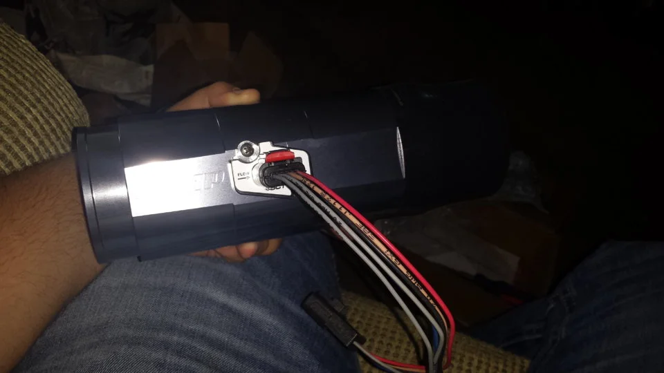

My only thought is to put a new and better MAF on it and retune. I'm completely open to suggestions though.

This is my future remedy. Now I need tune money. Taking donations :leghump:
