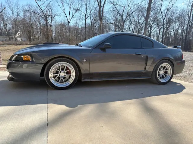

Then did some more work on the rear suspension. Currently cutting a 1.67 60 ft time on a 275/40 17 hoosier quick time. Looking for those elusive 1.5x's which is about all this thing can likely muster given current power levels.

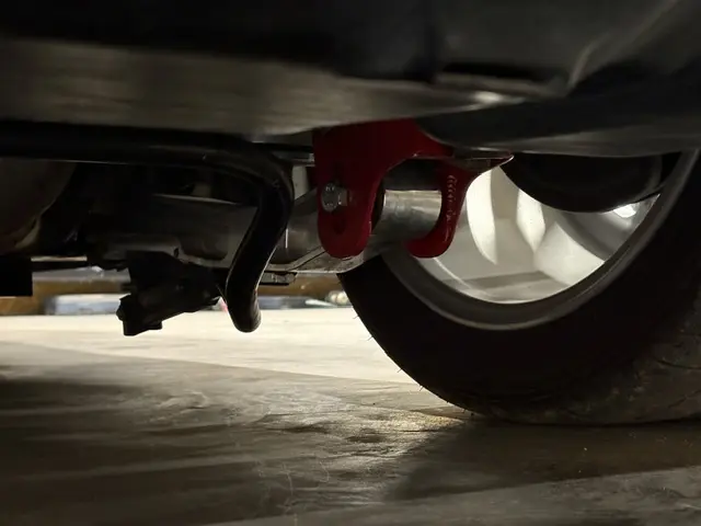

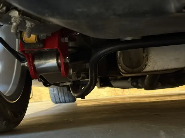

Rear setup - steeda weight jackers, bmr lca brackets (Welded in), team z double adj uppers, 31 spline, frpp cover, moser studs, on eibach sportlines (yes I know they hurt but man it sits nice) and Koni single adj shocks.
The main issue i have with this setup is sway bar mounting. Due to the angle of the LCA weight jackers, it made the sway bar sit almost 1 inch off the ground behind the rear pumpkin. I "fabbed" up a bracket to lower the front mounting hole of the sway bar 3/4 of an inch lower which got the bar to ride correct height in the rear but the front arm now sticks out like a stubbed toe.
I don't think a true "anti roll" bar is the right call for a car that see's the track less than 6 times a year (you could argue that for any of the rear suspension mods I suppose).

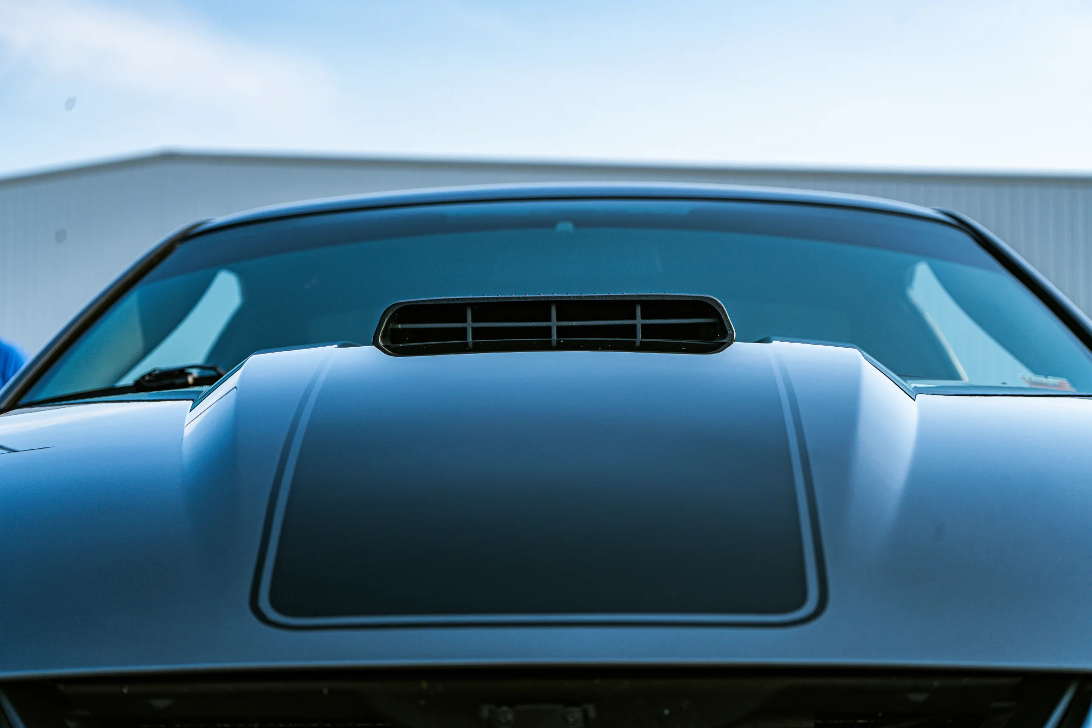

Reactions: gkomo

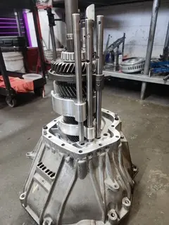

Update: sort of- parts are taking forever. Car is still at trans builder.
Got billet shift forks due to Heman himself jamming gears, All shifter key and springs, 5-R slider and hub assembly, 1st slider and hub assm. Bearings, seals, 5th bearing on main (tail shaft had been leaking since 80k - even with multiple new seals. carbon fiber synchro's.
Prob some more stuff but it'll be spec'd and blueprinted correctly and should shift like butter when all back together and broken in with the new spec 2+ clutch.

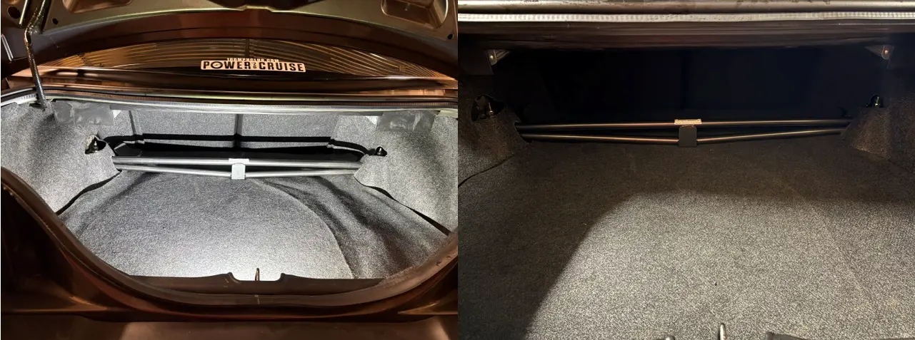

Kenny brown shock tower brace installed (took 6 weeks to get here). This was not as easy as I expected. First, it was a no go by myself as I do not have 10ft arms so that was most of the battle. Trying to hold bolts under car/shock tower and inside trunk at same time. Have a buddy or an unwilling wife. :D
Second, it had to be "drawn" down with bolts in the shock post holes to then mark side mount holes. And as we all know not every one of these cars are EXACTLY the same between the shock towers on the stamp tool PLUS 23 years of life and it would not touch the top of each shock tower at the same time w/o lots of help. I had to fashion some amazing washer stack spacers for just one side bolt -which I thought wasn't too bad. Dealing with the carpet (spare tire cover/board) and the nice layer of dynomat was more problematic to get things flush.
End goal is to run full coil overs down the road and solidify the chassis in the rear due to the hard launches (will have to do torque boxes maybe next winter).

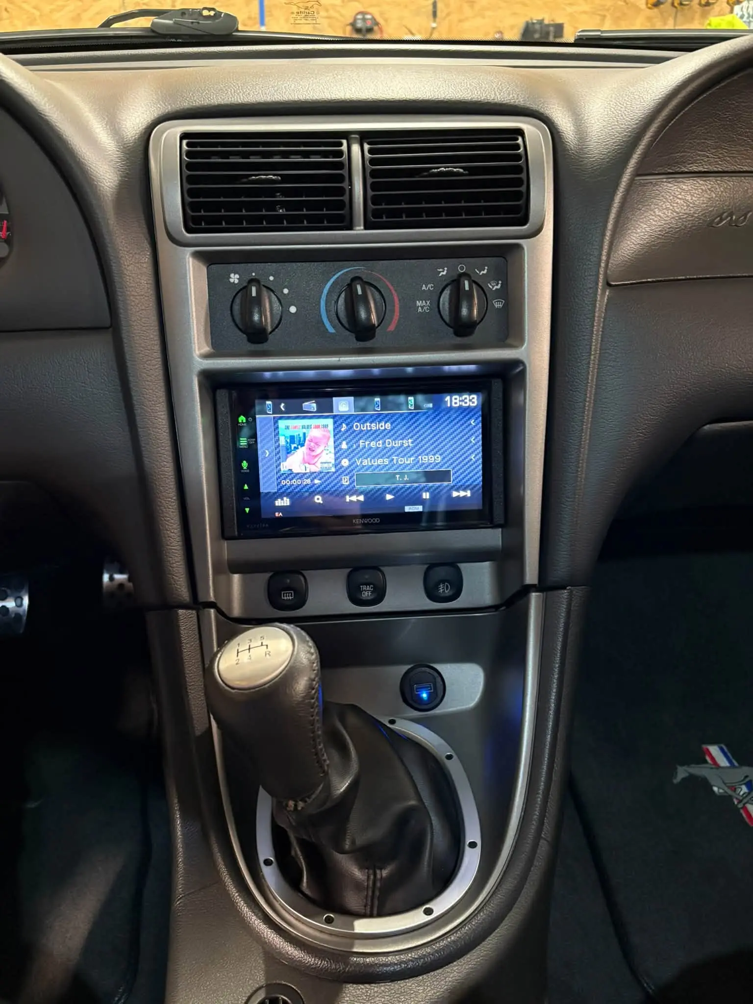

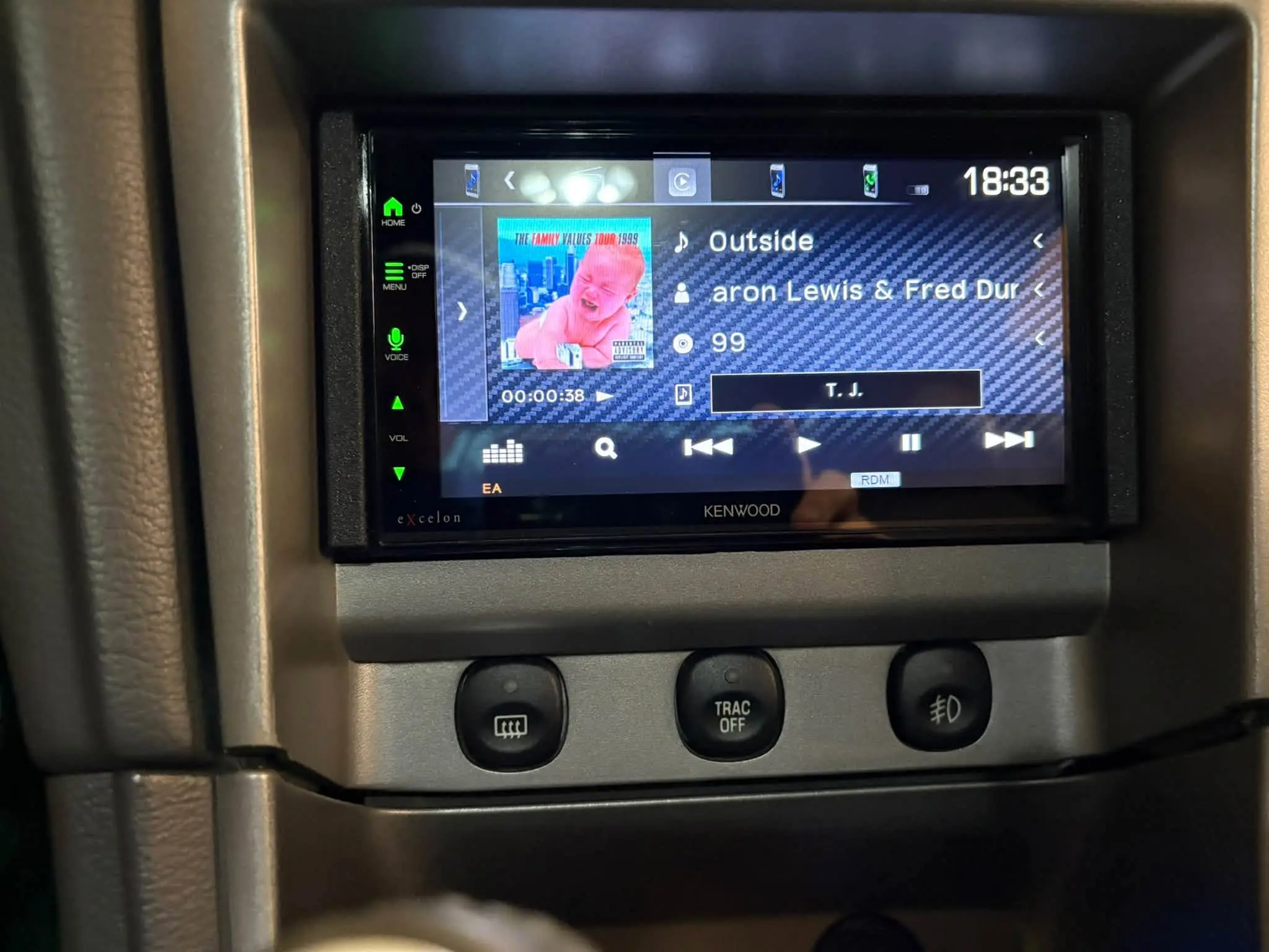

Installed a nice KW headunit. My CD6 actually worked but I was tired of my cig lighter, blue tooth, FM modulator for tunes and the crap sound quality.
BUT I tried installing an alpine last year and could not get the sound balanced. Had TONS of alternator whine even with ground loop isolators etc. Gave up and returned it. After a lot of research I learned I should be able to use a LC2i to modulate/throttle the rear mid/subs amps, so I don't have all bass or no bass.
Lots of wiring and a rat's nest - which I swear was clean on my bench when I soldered everything - we've got tunes and great sound quality. It's not going to win a contest, but it sounds as good or better than the stock Mach 460 - which I don't mind. And my quality while streaming XM off my phone or just songs on it is great. Plus, we can plug in car play for when we want maps up or something.
Also fixed the missing foam around the ac vents as they slide into the duct work. Last year sometime, they exited stage left when I turned the ac on, was good time driving down the road dodging foam pieces haha.
