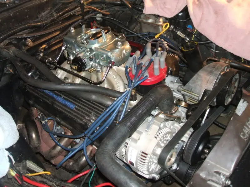

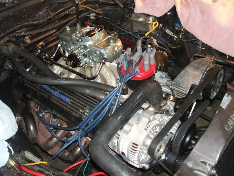

and it finally has a hood again:) but no air cleaner cuz theres no room. lol

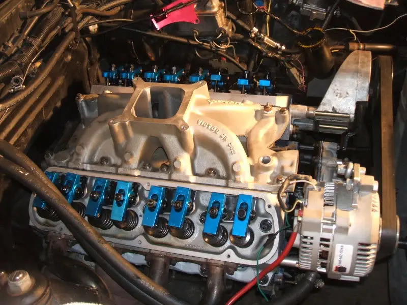

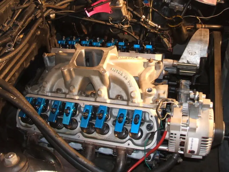

I see you added a vic jr intake. What is the engine like at normal round town rpm's? I was thinking of adding a vic jr to my 351w but many 351w guys I have talked to hate the loss of torque. I know yours is a 302 but how does it feel?
its ok. not much torque down low. i have to keep it at around 1800-2000 RPM to keep it from loading up. i think thats partially cuz im running extremely rich. once i get some smaller jets it will be better down low.
