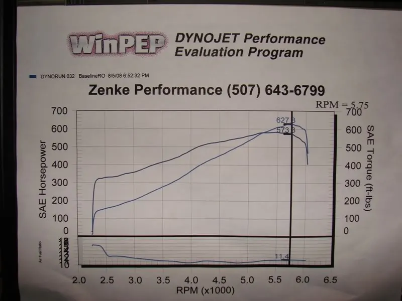

I got it on the dyno tonight, and after dialing the A/F in, I ended up with 627 rwhp. I think it should make a little more once I get a new belt on the s/c. It was slipping a little bit on the high end.
Here is a picture of the graph.

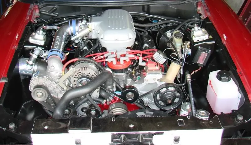

Here is a little engine shot

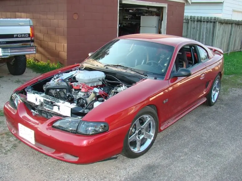

and a picture of the whole car. You'll have to excuse the dirt and dust all over it. This picture was the first time it was outside since last September.
The car funds have long since runout, so I am working on cutting a hole in the stock hood so that there is at least some version of a hood on it. For now I just runaround with it off. The car runs awesome. Idles steady at 800 RPM's, I can drive it around at 1200 rpm's without any bucking. So far I couldn't be happier with it. I use the car pretty much as my daily driver until the snow flies.

that looks absolutely killer... as well do the numbers... i rattle canned my engine bay just to get an idea of what it would look like black, and i like it.... yours make me wanna do it even more!

is that with the meth too? when does it kick in?
Wi Stang
Jun 27, 2004
248
Fountain City, WI
Aug 6, 2008
  • Aug 6, 2008
Yeah, the numbers are with the meth going. I have it kick on about 2 PSI, and it is full on at about 12PSI.
That is about what I was seeing for total boost. It would get to 12 PSI at about 5500 RPM and that would be it. even reving to 6000, it wouldn't go up. I am going to pick up a new shorter belt today and see if it will make a little more.

Had to order a new belt. I got it today slapped it on, and did a couple of 3rd gear pulls. I am now seeing between 14 - 15 PSI out of it now.

Yup, all tuned by me with the Tweecer. I played around with driveability, and once that was pretty good, I took it to the dyno and dialed in the wide open.
The only issue I really have right now is at a warm startup. The idle hunts if it is warm and in Open loop. Once it switches to closed loop after about 40 seconds, it idles like a champ.

From start to finish it took about 2 hours to dial in the WOT. It would have taken less time, but I tuned it for no methanol, then hooked up the meth and had to dial the A/F ratio in again.
Then we made a couple pulls messing with the bypass valve before we figured out the belt was slipping on us.
I probably had about 12 pulls on the dyno all together. The dyno place I go to charges $100 an hour to run.
It was really rich when I first put it on there. I hit it from 2K in 4th gear, and the A/F ratio dropped right off the scale. Looked like a diesel with the amount of dark smoke coming out of it. I leaned the whole MAF curve by 10%, and it still was less than 10:1 for the whole pull. Another 10% to the whole thing, and it started to come around.

What kind of duty are you seeing on your injectors at WOT up top?
In the logs I was seeing about 67% duty cycle, so there should be plenty of room to grow.

What are you shooting for on the AF ratio. That doesn't look bad up top.
Whats your timing curve like?
I was trying to keep it in the low 11's for A/F. It seemed to like it there. Any fatter or leaner, and I would loose a little. For timing I'm running about 16* max. Trying to keep it pretty conservative for now.
