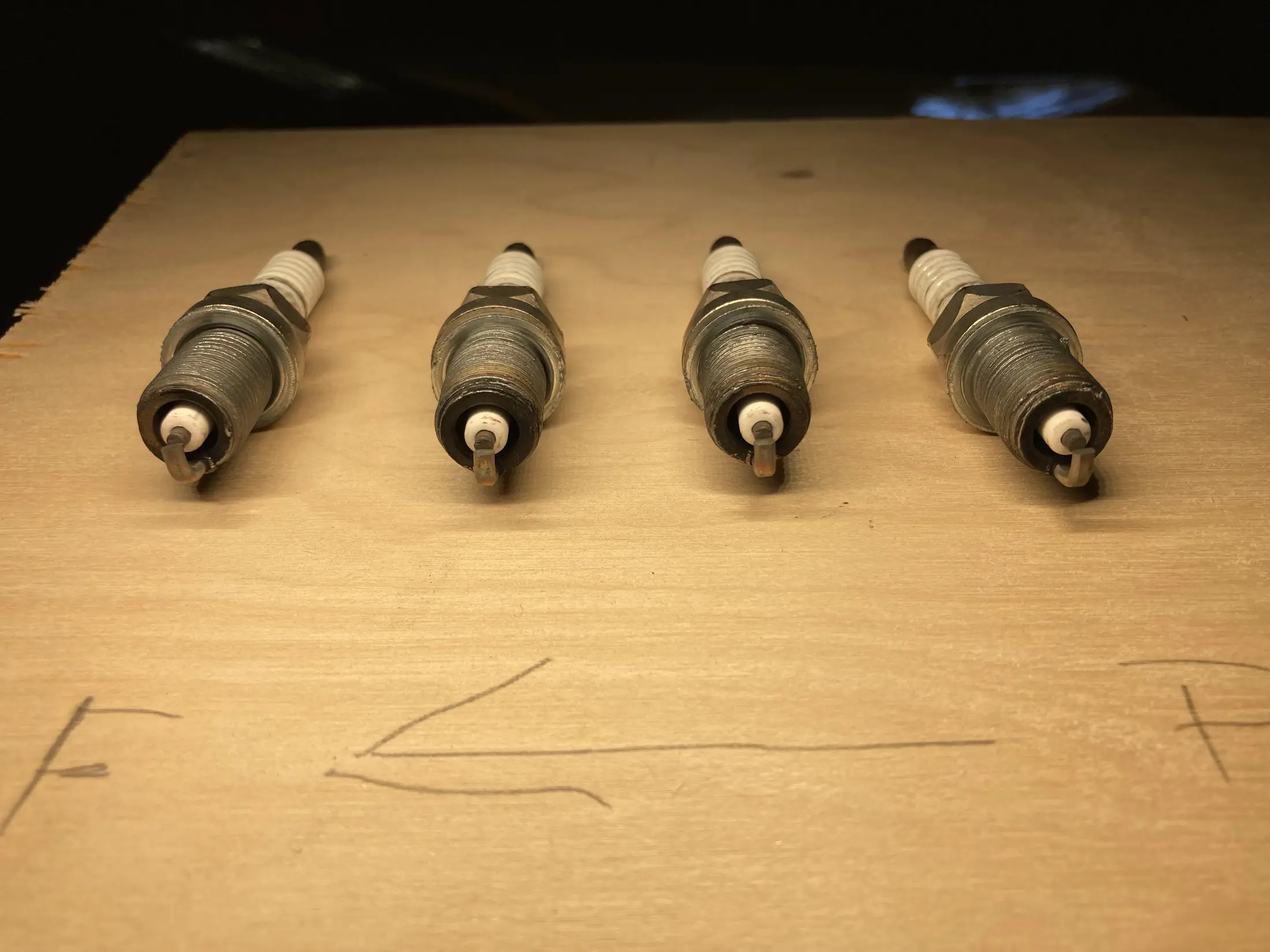

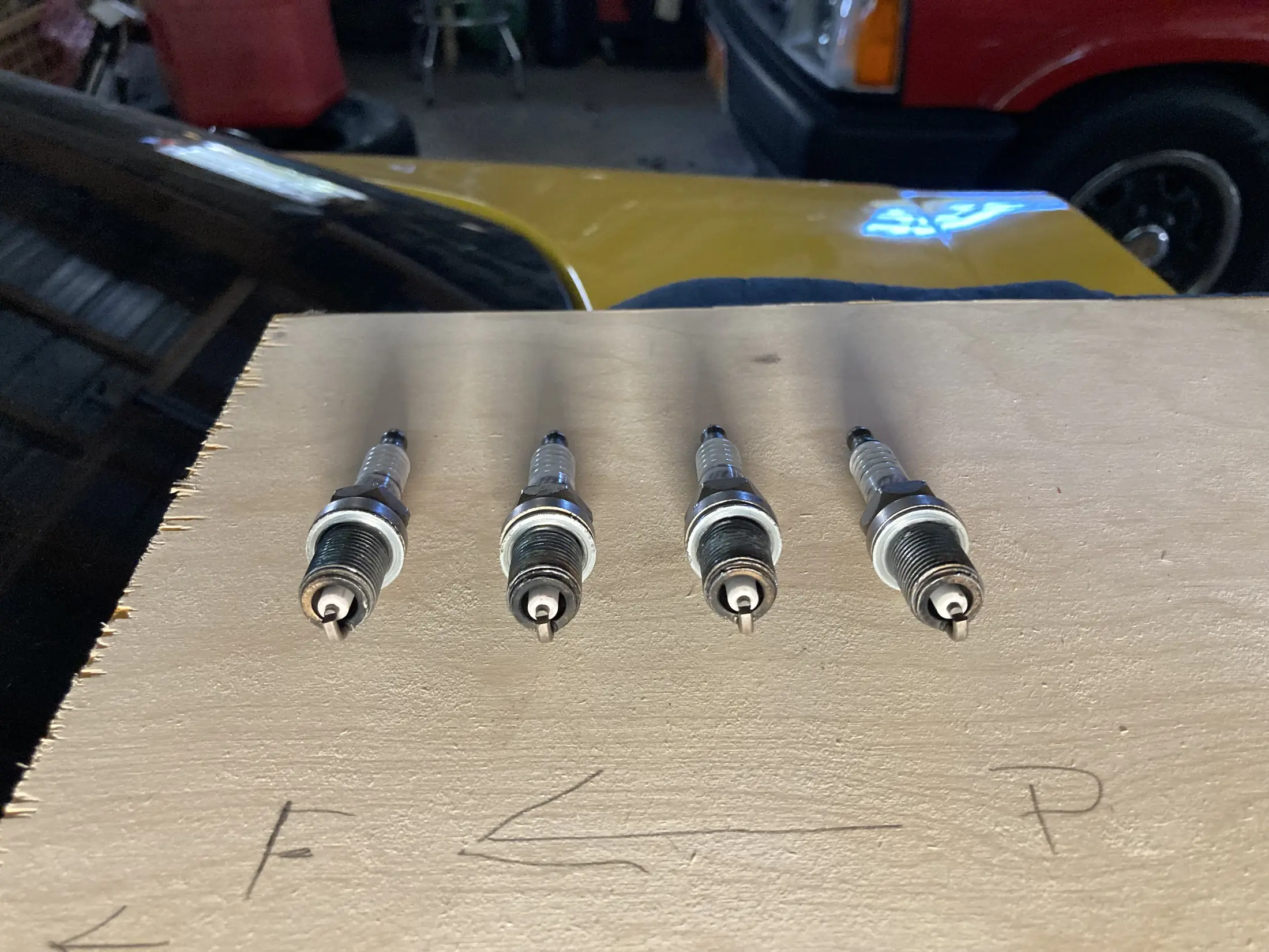

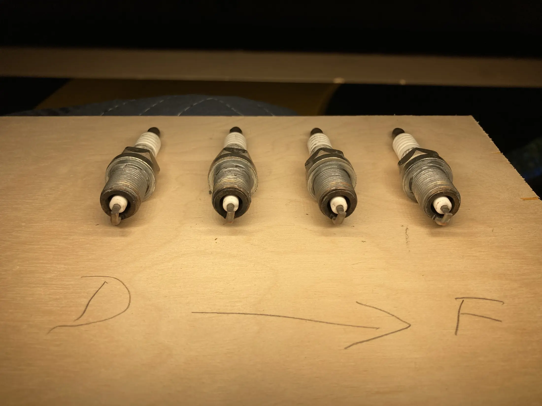

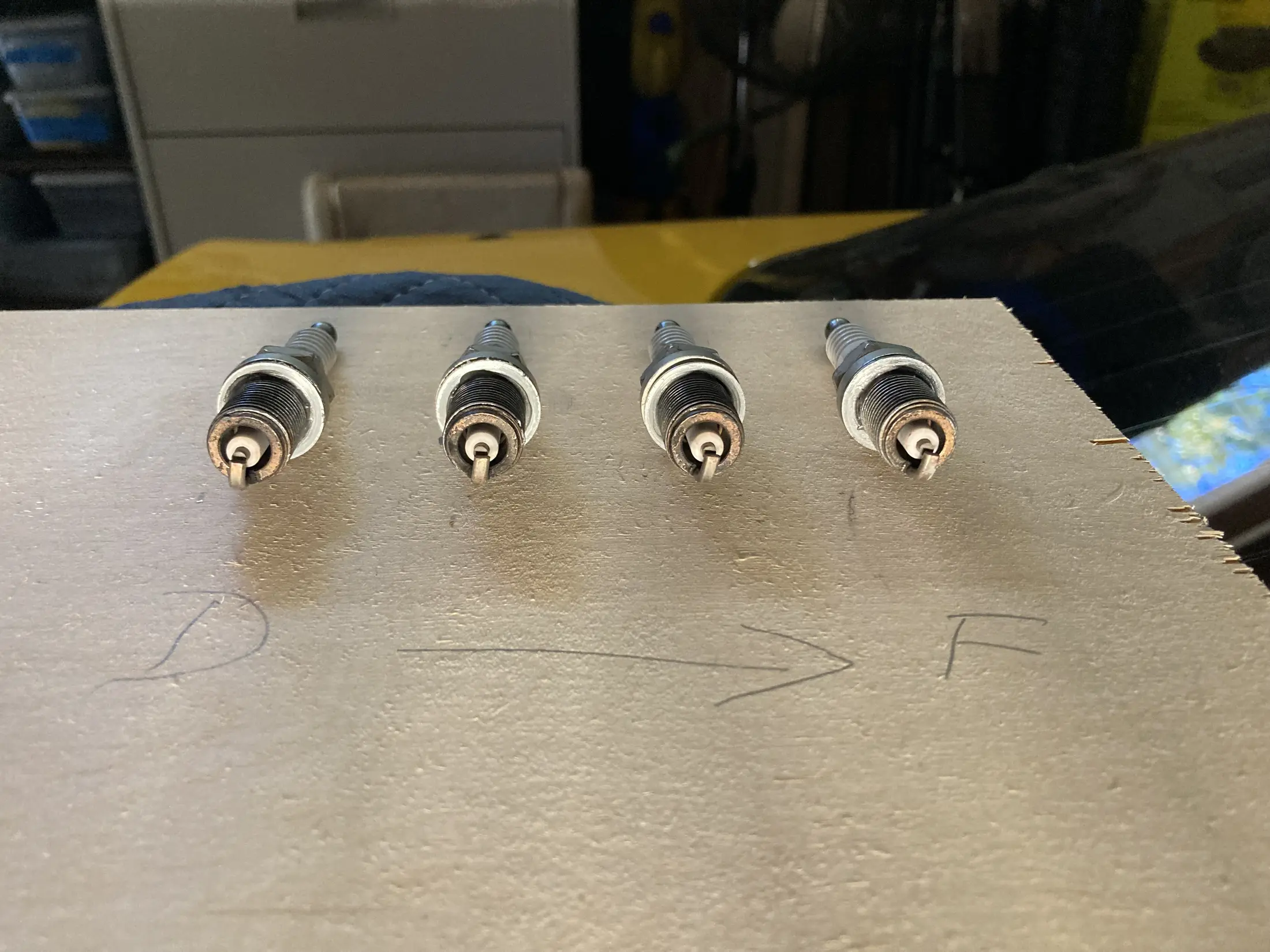

Here’s pictures of plugs. They are Autolite 3924’s. Pencil marks indicate location. Maybe 100 miles on these

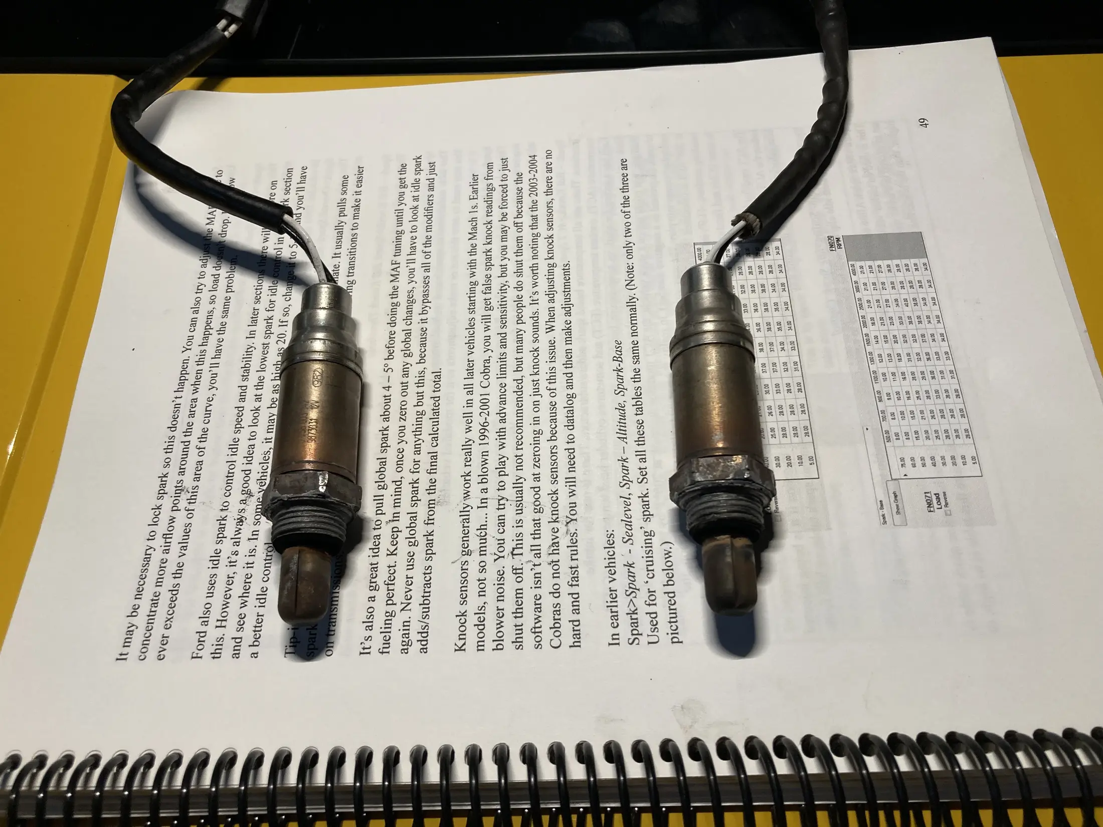

Bosch 942. I’m going to swap sides when I put them back in. The wiring and connectors look good.

The switching of the two sensors compared to the wideband looked very good too.

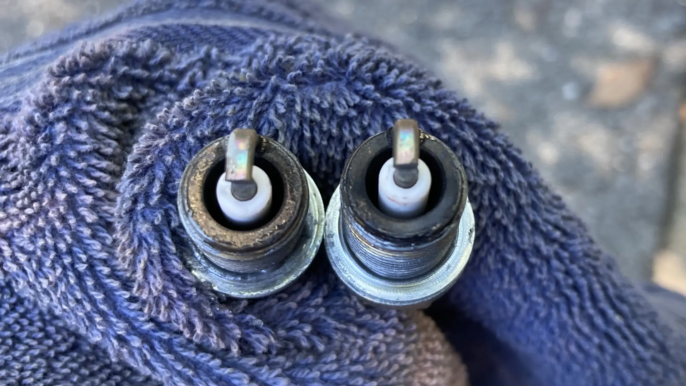

The base of the spark plug thread body (part that is exposed in the combustion chamber) of plug #2 is darker than all the others. Heres #2 compared to #5. The rest of the plugs look mostly like #5. Maybe something is up with #2 injector? If it were dumping more gas than the others, would that explain the ECU working to pull gas from passenger side?

It is possible but I have no way to tell.
The plug on the right does look a bit 'sooty'. Do you have any oil sitting in the intake behind the throttle body?

no oil on the intake under/behind TB

Im going to swap position of plugs 2 and 5. That way I have a cleaner one where the dirtier one was. See what happens when I inspect them next time.

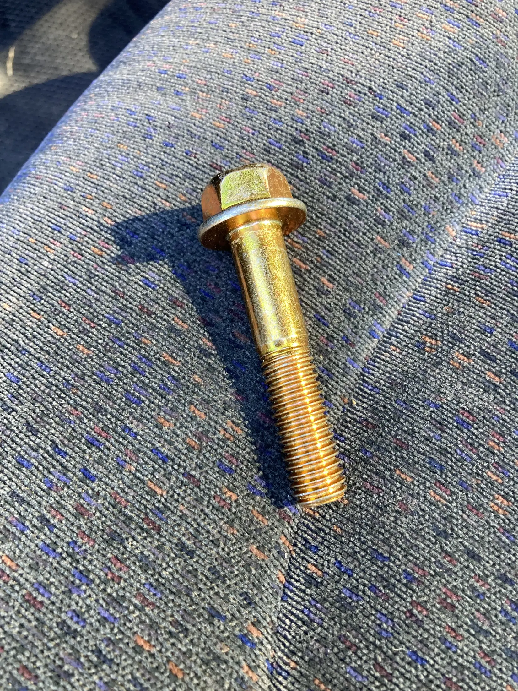

On the pull thread repair. I’ve seen discussions online about using 1/2” 351 head bolts in the 302 block with various people claiming lasting success. Considering I have AFR heads with holes sized for 1/2” bolts, is it a viable option to drill and tap for use of a 351 bolt in that one location? Of coarse, I would stick with 302 torque specs. Or, is the Time Sert my only real viable option?
In reality, the Time Sert option calls for drilling the initial hole larger than would be needed for the 1/2” bolt. Thus, if done successfully the 1/2” head bolt option would leave more block material in place.

Here we go. 1/2”x13 coarse x 2 1/2” grade 8. Exact dimensions of the 351 bolt for that location. The AFR head is already sized for this. The hole required for the 1/2”x13 tap is smaller than would be needed for the Time Sert option. I can easily try this bolt and do the work without removing the head. I will need to remove the header in order to get the bolt in and have clearance for torquing. If I mess this up there’s still another chance by pulling the head and using Time Sert. I’m drilling and tapping for this bolt for my first attempt at solution.

Question: What do you torque this bolt to in comparison with the others?

I’m taking it to 70 ft lbs which would be the stock tq for stock 302 bolts.

Thread sealer on the threads and a oil on the head to bolt washer surface

I'm just gonna toss this out there because I don't know how critical is is for aluminum heads but...
Those bolts are torque to yield and two different diameter bolts torqued to the same spec, are not even.
